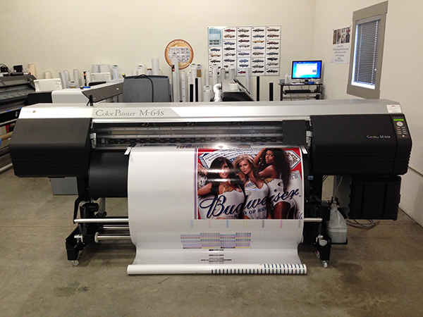

Just got our new M64 installed! This thing is a beast.
2 used printers away from being an all Seiko shop.

We just got one too. It's the fastest printer I've ever worked with, and the print quality is really good with CMYKLcLm+Gray.
What do you think about the take-up? The prints seem to telescope a lot on mine.

I just started running a production job on it, I'll keep an eye on the tunneling. I noticed there are no level adjusters on this takeup like on our W64. If there is a lot of tunneling, it'll be interesting figuring out how to fix it.
And yes, the speed will be nice. What took 6 hours to print on the W will take 2 hours to print on the M.
