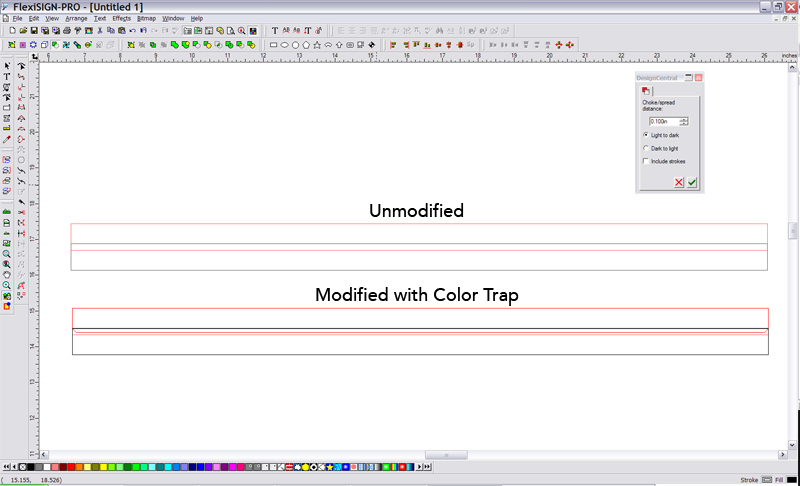

The color trap ... also called choke and spread, simply recreates the overlap/underspread of one or the other objects to the desired amount in Design Central, determines which is the overlapping object and tapers the corners in of the underspreading object. In the attached image you see the effect in FlexiSign.
This is how it is done in the software side of things. The basic wisdom of it as well as the application techniques is a whole different matter.

I'm just trying to cut one color vinyl and lay it down and then lay the outline over that with about 1/2 inch overlap all the way around so as not to have any back light show through cracks. It's all just text, but in viewing your tile, I still don't quite get it. Must be being 57 yrs old. Thanks anyway. PS Love the Pug
