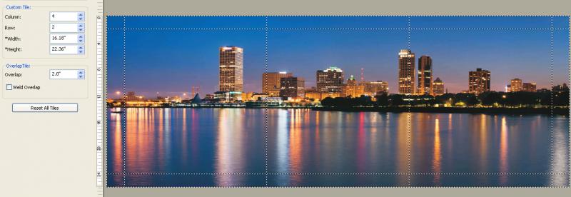

i think that's what he's doing, but forgets that the outer perimeter of his original image will not generate a tile overlap that he wants to wrap around the sides.
that's why he's gotta setup by treating the outer returns of his canvas/frame as a tile.
For example:
attachment.php
...and only print the 3 tiles in the center of this layout. they will be printed with the bleed you're looking for. (assuming you're looking for a 2" wrap-around.

Dont forget with the wrap in that pic above, you likely need 2 inches to BOTH sides. I know VW can do that pretty easily.
