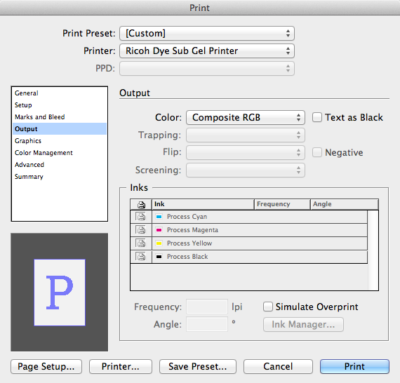

That's what I'd think, but it's grayed out where is says "Flip" in the output box. Here's a screen shot.... This is from a Mac, but it does the same thing on the PC.

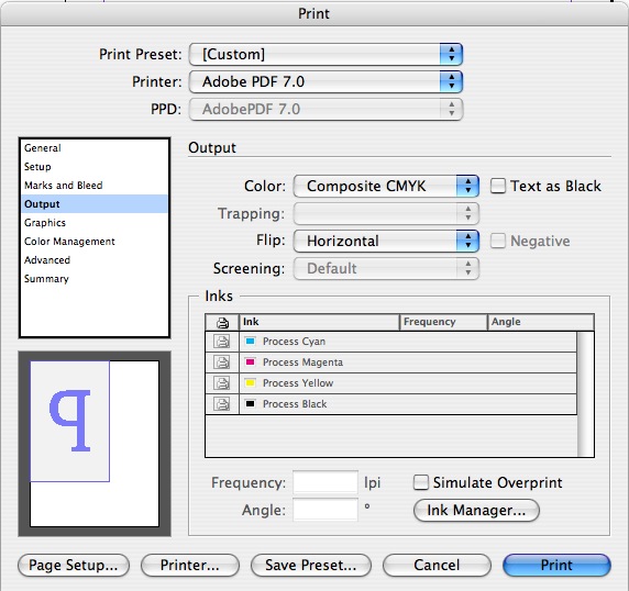

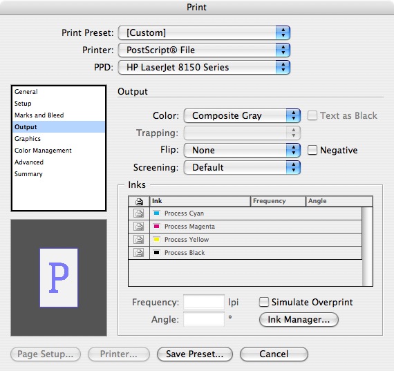

SebastienL
I think it as something to do with you printer.
I created a new file and hit print to see what option I could use. I changed the printer in the printer selection box and the "flip" option box lit up. It works also when PDF is chosen as a printer. So maybe that's an option, output to PDF and print from Acrobat.

Thanks! Okay, so I now have another question about it. If I select "PostScript", then in the box under it "PPD", my printer, then it shows the flip option. Is there any problem with my selecting PostScript, and then my printer, where as before it was just my printer and the "PPD" part was blank.
Will that work, or does that do something I probably won't like?
