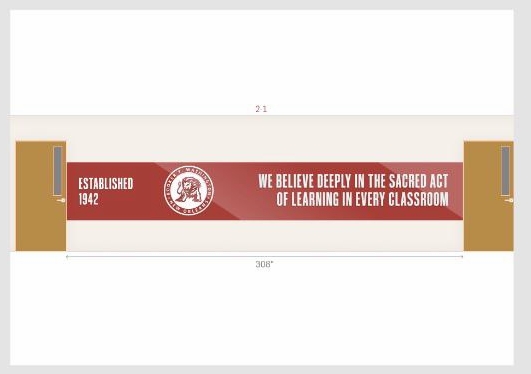

We are working on a project that requires some letters painted on a wall.
What would be the best combination of vinyl and paint? I assume gloss paint would work better with vinyl? We use Sherwin Williams super paint and can choose a sheen.

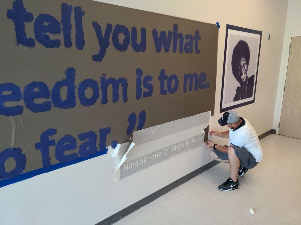

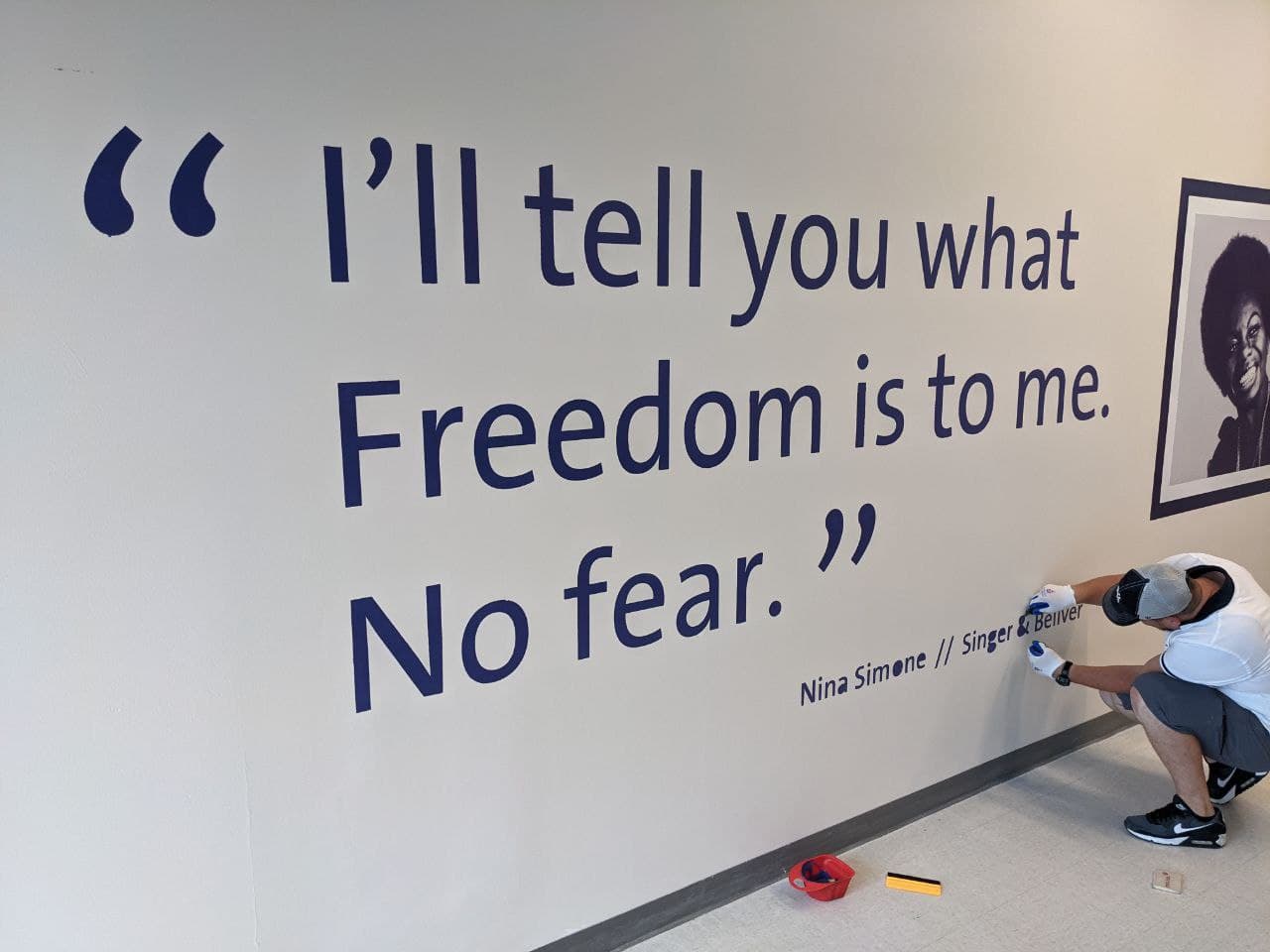

We finished a big job this summer using Oramask 810 and had to cut everything with a brush. We used a sponge to apply paint to prevent it from leaking.
Thank you.
