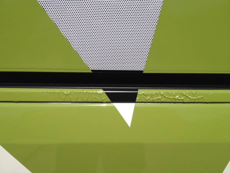

Recently installed Avery SC900 on a van. 3 weeks later there is a section of plastic molding between the window and painted body that looks like someone took paint remover to a painted surface. The effected area is about 3/4" high so if we have to leave the vinyl off that area it would probably have a minimal impact. The area was cleaned well before application but I am wondering if this plastic's composition does not work well with vinyl adhesive.

Got in touch with Avery today and they told me the SC900 was not compatible with the vehicle molding.
