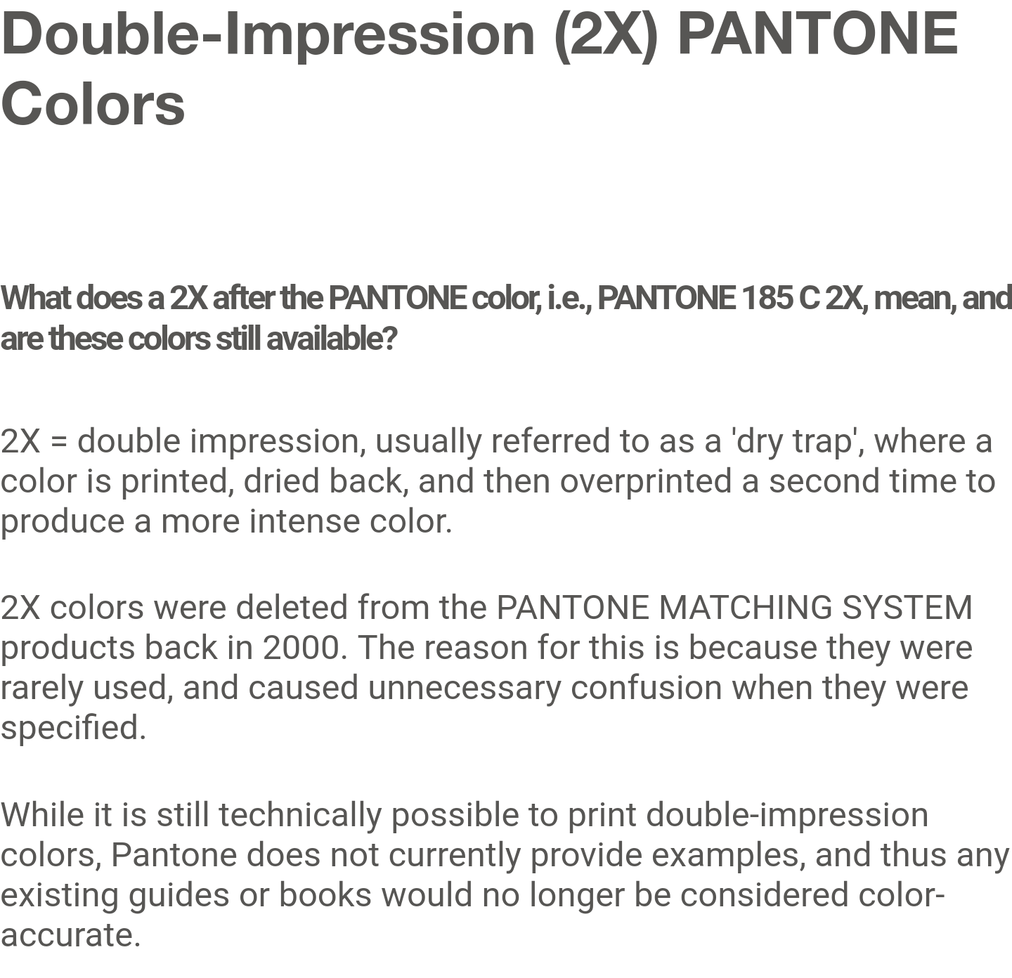

Question Pantone 306 2X CVC. What is "2X"?
Moze
mpn
It's a printing term for double strike. It takes a double strike on the press to get that color.
Lea Marc
Thanks. Our old Mimaki had the capability to "double-strike" a print. We used that option when printing to clear backlit vinyl. I was told our HP360 can't do that.
