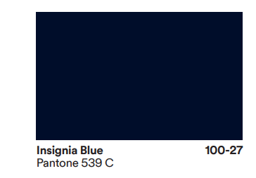

https://multimedia.3m.com/mws/media/653312O/color-card-100.pdf
The RGB equivalent for PMS 539C comes up as R 0, G 43, B 69.
I've attached an Oracal color conversion chart to reference those numbers against. Hopefully, that will help.
