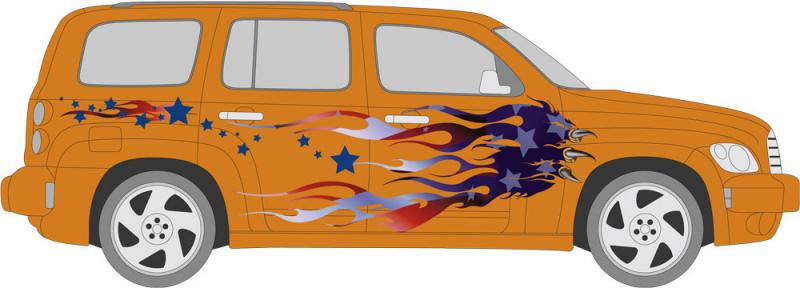

I did one like that on an HHR. We used application tape and put down the larger/flat areas first, then removed the tape from the tricky contoured areas and installed them with only a few small pieces flopping around... I don't have a photo of it, but I do have the proof artwork.

I tried that once. It worked, but It was nerve racking!
