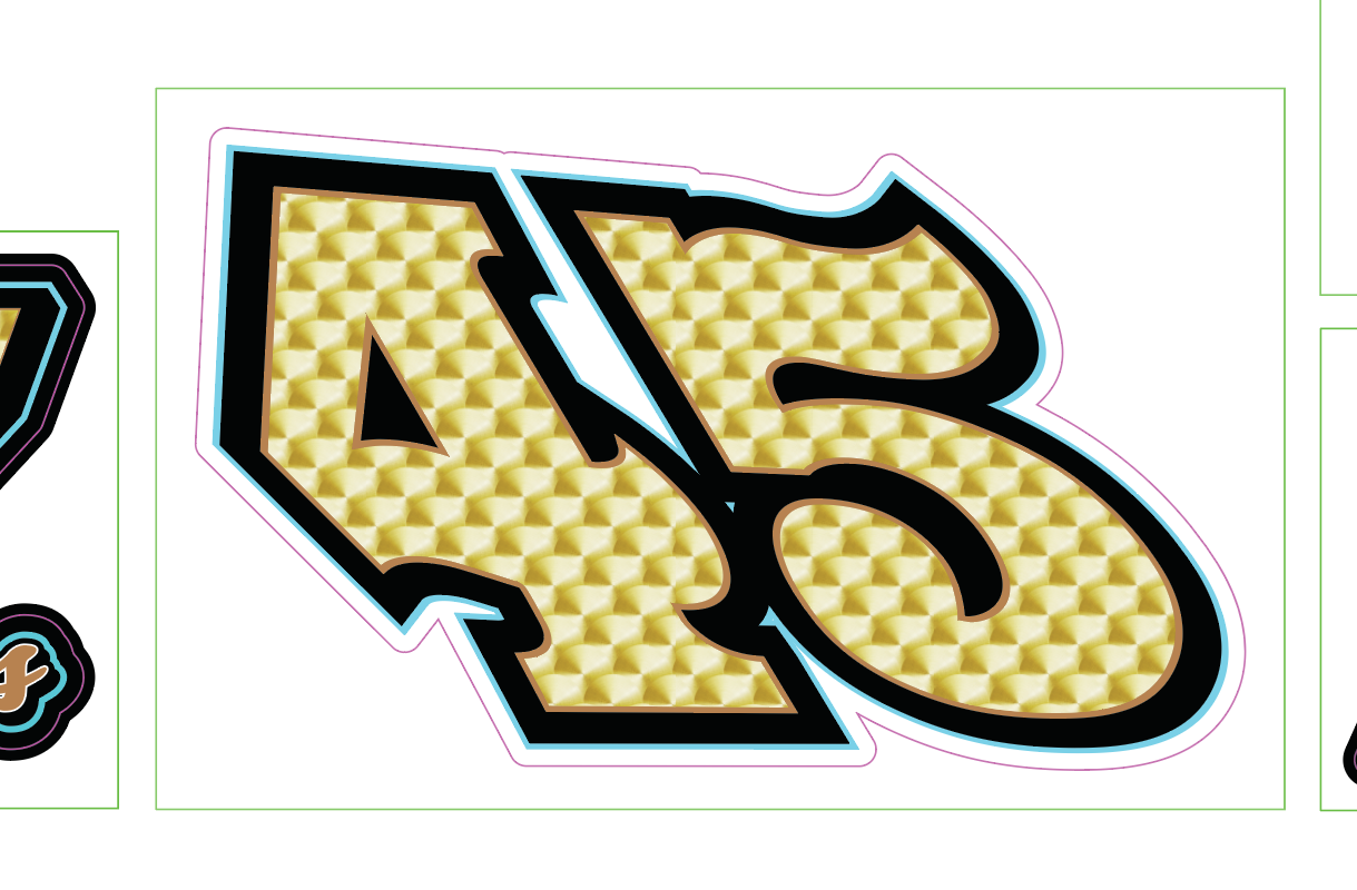

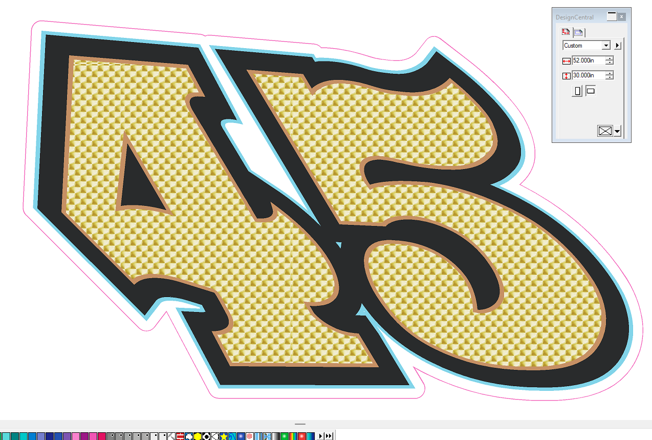

Everytime I save the print file and open it in Flexi, it resizes down the pattern. Anyway I can change a setting in AI or flexi to make it stop?

Saving as pdf then opening in flexi or just opening the ai file?
rasterize the pattern?
Geneva Olson
Expert Storyteller
export it as a png. You might have to make it larger when you get it into flexi. For example, You can compress it in a 52x30 jpg or png but when it comes into flexi, it might be sized proportionally smaller. Then just resize it to the correct size when it comes into flexi.
I say export it in a png because you can still do contour cutting around your graphic.
