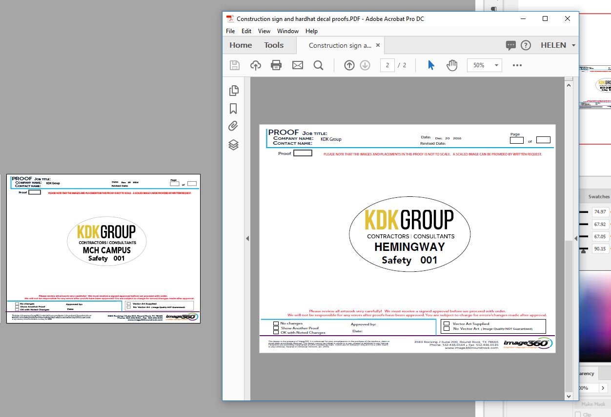

So I had a customer send me a PDF file and when I open it in Illustrator and Adobe Reader, it shows two different versions. Anyone have this problem before?

You're looking at page 2 in acrobat, did you open page 2? Might want to check the layers.
Go to file>place, place the document then click on it and hit embed on the top menu bar.
I don't think this is something that can actually happen lol, but I may be wrong.
AKwrapguy
It looks like they sent you a PDF with two images. I Illustrator you have to choose which one you want to open.

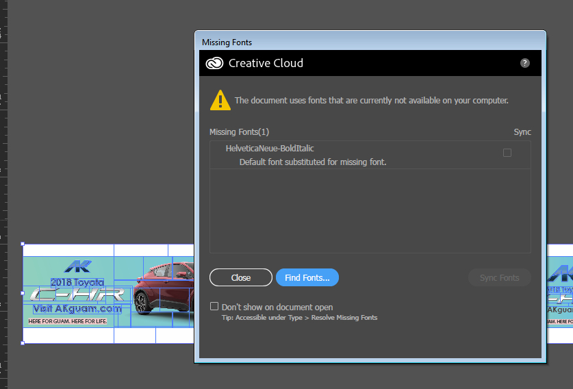

Were fonts converted when the pdf was created? "Place" in illustrator as suggested will convert the fonts. Sometimes if you don't have the fonts it'll come in "jacked up"

How can I open a PDF in illustrator and convert text with a missing font into outlines
This used to work but not so much any more.
Maybe it is just files with images in the background but I get this error message more often than not:
When I click the embed option the missing font message pops up and we are right back to square 1.

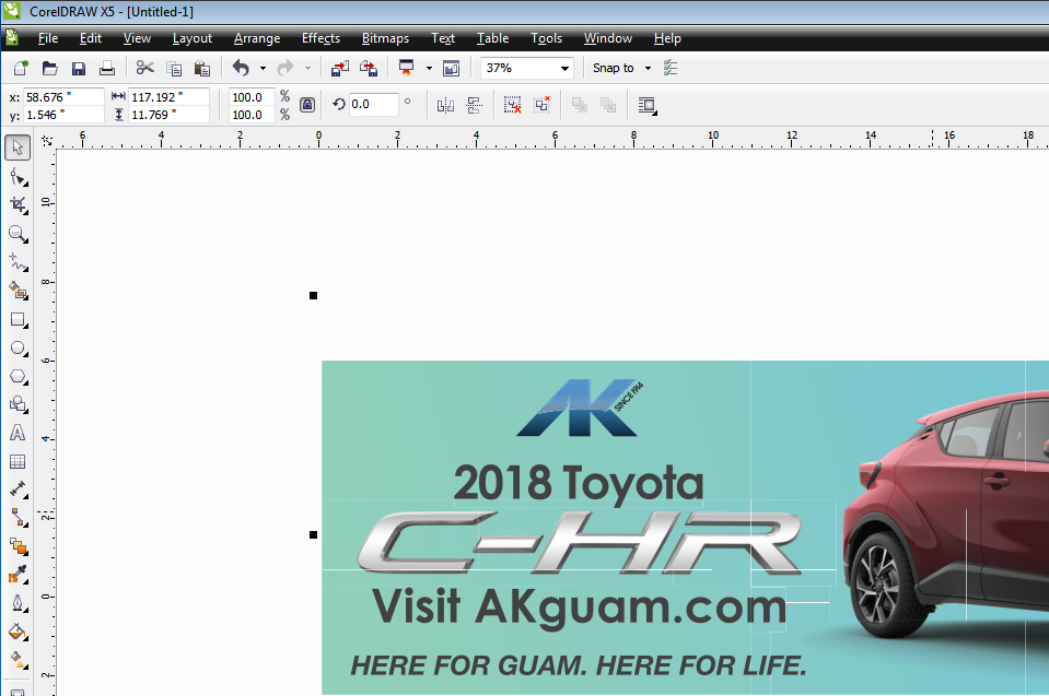

Surprisingly when I import the same file into my old but trusted CorelDraw X5 and ask it to convert the fonts to paths on import...it does.
Providing further proof of the '1000 times faster than AI' theorem.

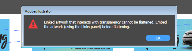

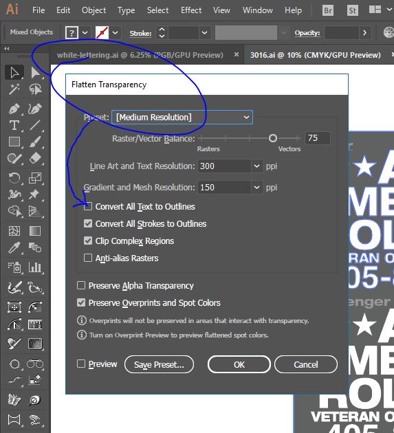

When using "Flatten Transparency" on a linked file -- make sure "Convert All Text to Outlines" is checked.

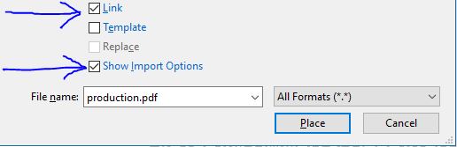

Also, when opening a multi-page PDF... it's usually best to create a new document, then use File > Place and select "Show Import Options". You can only open a single page from a multi-page PDF when using this method (it will give you the option to navigate each page with thumbnails previews / page numbers prior to import), but this will preserve the file "linking" option, after which you can use Flatten Transparency, as mentioned in my post above.

It's no big deal at all to convert fonts embedded in a PDF to outlines. That's easy. Just place the PDF into a new document, making sure you check "link" when placing the file. Then go the "flatten transparency" dialog box. Make sure to check "convert fonts to outlines" and pull that quality bar on vectors to 100%.
