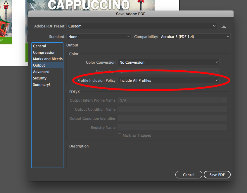

Hello All -
Just trying to find documentation online for the adobe PDF save setting under "Output" the option for Profile Inclusion Policy, "Include All Profiles" - I'm assuming that this setting includes all tagged RGB/CMYK/LAB/ETC. profiles, but for untagged or native elements does this assign the working color profile from color settings?
Other settings indicate they include tagged and assign RGB but leave native elements and untagged CMYK unassigned, but I want to make it so all elements in my PDF files have ICC profiles tagged/embedded, so I'm hoping someone can confirm that the Include All Profiles does do this.
Thanks!

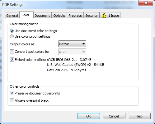

I use Corel Draw so I can only speak for how I export from that program. When preparing a pdf to send for large format digital printing.
I'll start with Document Distribution preset. Under the color tab I'll make sure that "Output colors as" is set to native. Check to make sure Embed color profiles is selected. This should be the usual sRGB, US Web Coated (SWOP), and Dot Gain 20%. Next under the objects tab I select compression type as LZW, I'll uncheck bitmap downsampling, check compress text and line art, check export all text as curves.
I avoid the x-1 and x-3 setting when exporting because it converts all your colors to cmyk. For offset printing this is ok (i think?) but for digital printing it's better to have rgb colors as your standard. I've never had problems with color reproduction using these settings.

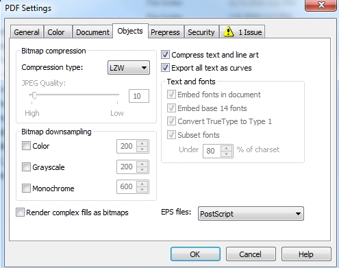

I just went through the pdf settings in illustrator. No option to convert fonts? Is that something done manually or maybe by turning off "Preserve Illustrator Editing Capabilities"?
bannertime
I'm not exactly sure what that option does, but it doesn't do anything to the fonts. Will admit that it's pretty dumb. Nothing to automatically embed linked images or expand fonts.
But for OP, I'd just go through and make sure everything is same across the whole document before packing the file to send or print. Depending on your RIP you could confirm your theory by importing the file and looking through the colors. I know it's possible in Production Manager so I assume you can in others.
Asuma01
I convert fonts to avoid missing font errors. In Illustrator you have to do this manually I guess. convert to outlines I think it's called.
After you select a Profile Inclusion Policy, move your mouse over it and it'll show a description of exactly what it does.
I believe x-4:2010 'fixes' that issue.
Only x-1 converts to CMYK. x-3 and x-4 allow RGB.
PDF files have fonts embedded in them. There's no reason to convert to outlines because the outlines are in the font itself, embedded inside the PDF file. That's how PDF files work.
All content including images are normally embedded in a PDF exported from Illustrator. The only way to get a "linked" image in a PDF from Illustrator is to enable the "Preserve Illustrator Editing" option, which adds metadata to the PDF that allows you to open it as an Illustrator file. The images are still embedded in the PDF, but they'll appear as linked.
No, you don't have to convert to outlines in Illustrator. PDF files have fonts embedded in them, as mentioned above.
I just discovered that you are right. But I still have to go in and manually select "output colors as native" manually. It's still just another setting I have to change. With Document Distribution it defaults as native.
