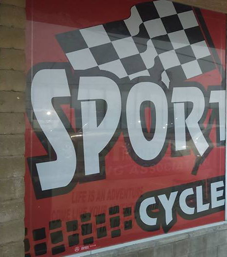

Would you do overlap even with perf? Most people say to do it butt
88" (2 panels) wide window with 1" overlap, them trimmed down the center.
Melks
I would prefer to go with 2 equally sized panels. Overlap then trim down to create butt seam. I use edge sealer tape most of the time so I would run a strip down the seam
