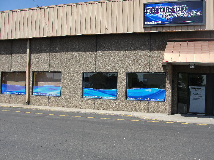

Most pref is only warranted for 6 months to a year. Cheap or not, the suns going to bake it. We've had perf on our windows at our shop for over a year, and still looks as good as day 1, and tons of sun hits it. We also didn't even laminate it.

Printed like you have your windows... we have absolutely no problems. And we do tell them a year as far as "warranty"... but I've never seen perf turn brown like this
