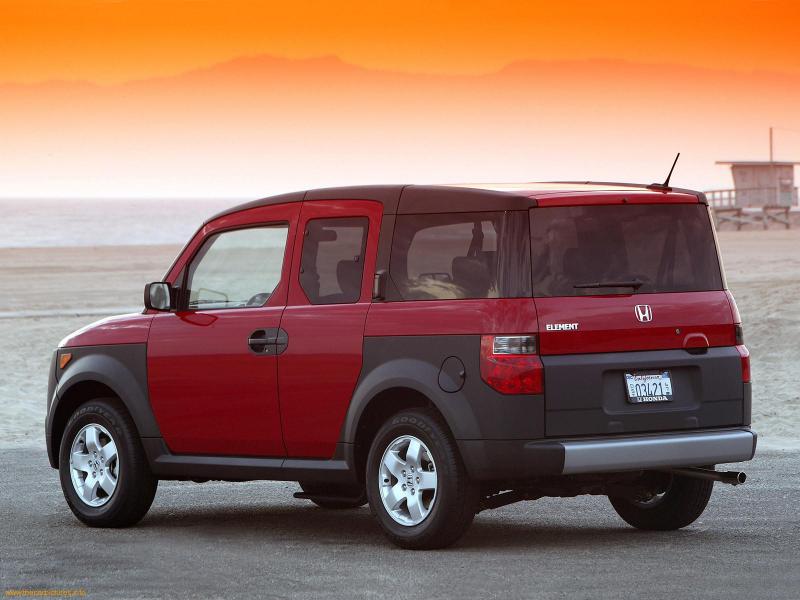

Hey guys, Wondering if perf will go around the little bend on this honda element window on the side fine. The perf will have cast lam over it.
Thanks!

Yes it will. Did an Element about 3 months ago. Just make sure you seal the edges of the perf.

Sounds good, What are you sealing the edges with, clear lam strips?

Are you trimming the pef back 1/4" then applying it?
I would think cast optically clear lam strips would work also, No?
Aklaim
Yes we trim it back. And yes lam strips would work just as effectively. We used to do that, but it's just more convenient for us to have a few rolls on hand especially at the price point of $11 a roll.

Awesome, How are you trimming it back, like whats the method to do it?
Thanks!
ProWraps
there is a perf trimming tool in the fellers catalog that uses and olfa knife. or you can just use two olfa knives held together.
