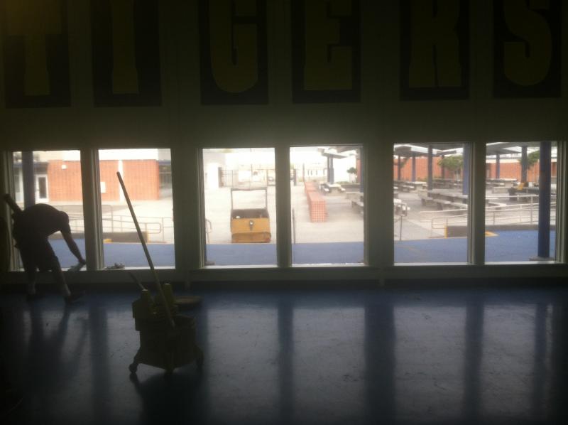

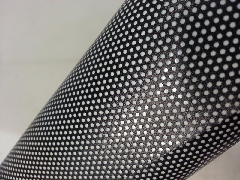

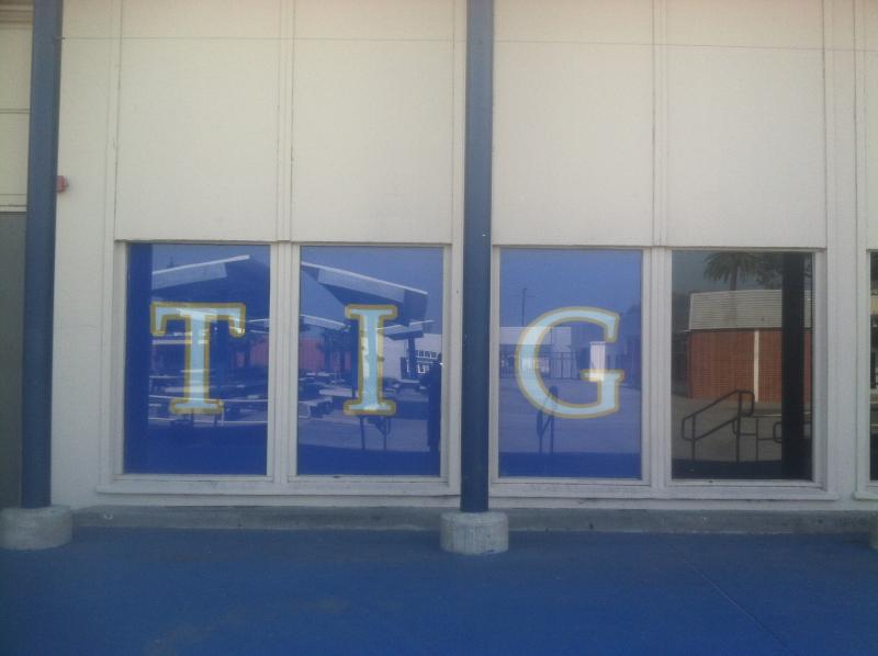

Print on clear.
What I have done is this:
Busted out the micrometer and measured the holes and spacing.
Used these measurements to design a pattern that matched the perf hole size/density I needed.
Printed the image, face down on clear (Flatbed).
Then printed another pass in black only. Has the same impact/function as normal first surface perf.
The only issue: Designing the image.
My panels were 4'x6'. Even though it was all vector graphics, because of all the little shapes, my files were massive. Took a long time to layout and a very long time to save (every time, every mouse click).
And before you say it, the machine I design on at the shop: 32GB ram, solid state drives, i7-3770k @ 3.5GHz. So the horse power is there. Just created really complex files. I designed the per pattern in Illustrator.
I guess I could have done the same in flexisign, but I had to turn this quick and I couldn't think through a good process for flexi fast enough.
God bless you if you have to do this with any raster images.
Check out the pics of the process and the end result. It came out pretty good I think.
