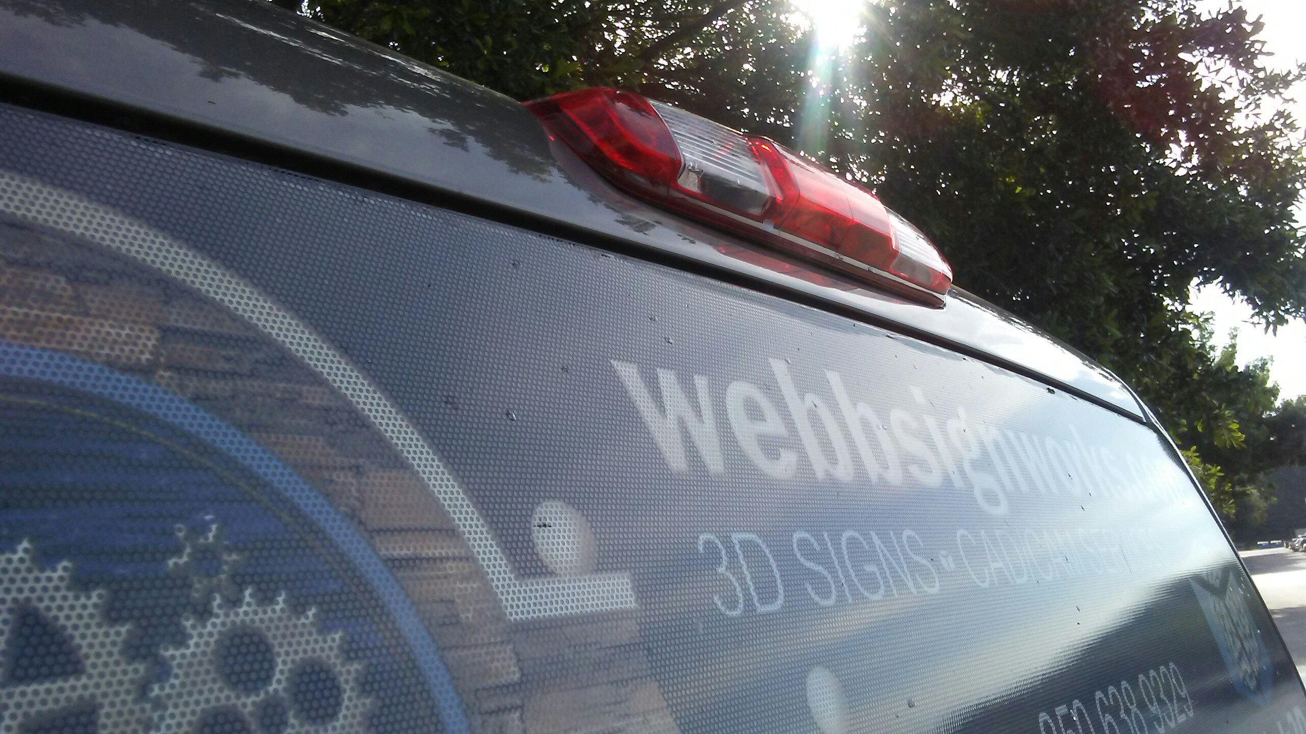

The graphic on my trucks window has been on for a couple years but still looks fine. It's beginning to come loose at the top edge. Is there some type of adhesive I can dab up there so I can get a few more months out of it before trashing and re-doing it? Thanks! :)

Be glad you got that much out of it. Window perf was never meant to be a permanent thing. One year at most..

yes i would trim it a little and seal the edge. you can use optically clear laminate strips to reseal the edge

If you don't want to cut it back just use primer. I don't use clear tape. just primer around the edges. Doing it for several years. No issues.

As mentioned, 3M Edge tape would do the trick. If you dont have tape / want to just use materials around the shop... All 3M edge tape is, is optically clear overlam cut into a strip. Just cut a small strip of overlam and use it to seal the edges... Won't look as good as optically clear, but if you plan on changing it in a few months and don't have any edge tape on hand, it'll work in a pinch.

because the primer does not give the needed build up around the edges to properly seal it and the primer will trap more dirt on areas where it is exposed
try this if you prefer a liquid seal
