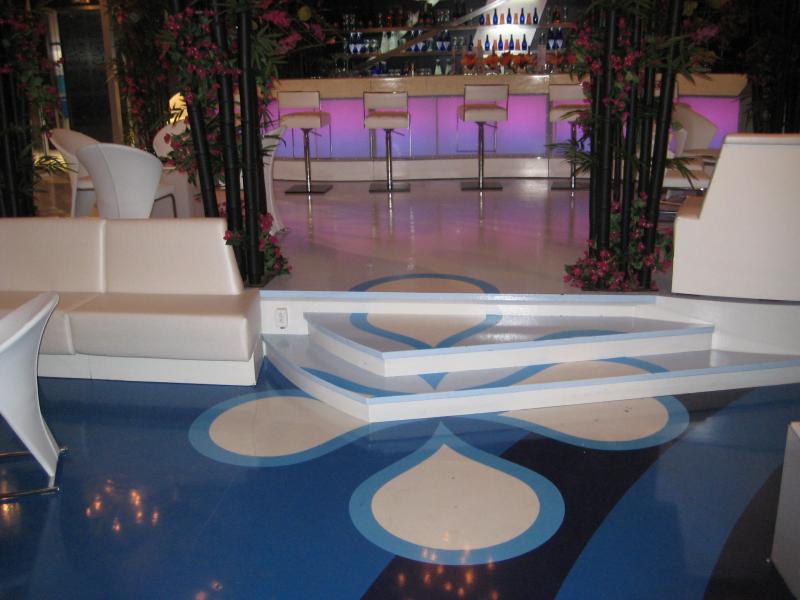

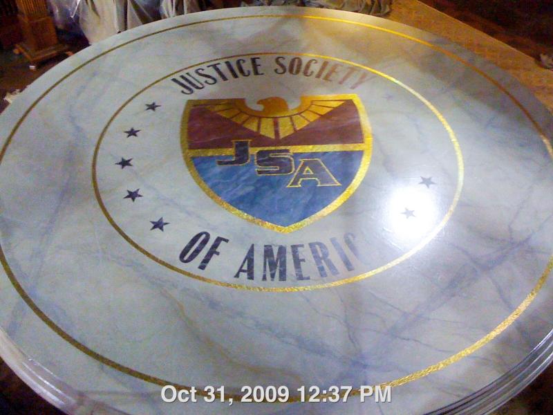

I've done this on many film sets. Here's what I've done with success. Print on calendared vinyl (it's film so it doesn't have to last forever so you may want to use cast).
We've done it with 2 part epoxies as well as just a water based clear coat and even varnish in some cases. Always test to make sure the product will not interfere with the ink.
Clean the surface properly. Lay the vinyl on. Make sure the edges have good adhesion.
Cover with clear coat.
In my experience, the clear coat usually fails due to the fact that the jobs are rushed and not applied properly. Again, this is stuff I did for the film industry so...
The Justice league is a combination of print/cut vinyl and cut vinyl over marble faux finish. If I remember correctly, we used a high gloss water based clear on this.
The floor is print/cut vinyl with an industrial 2 part epoxy.
