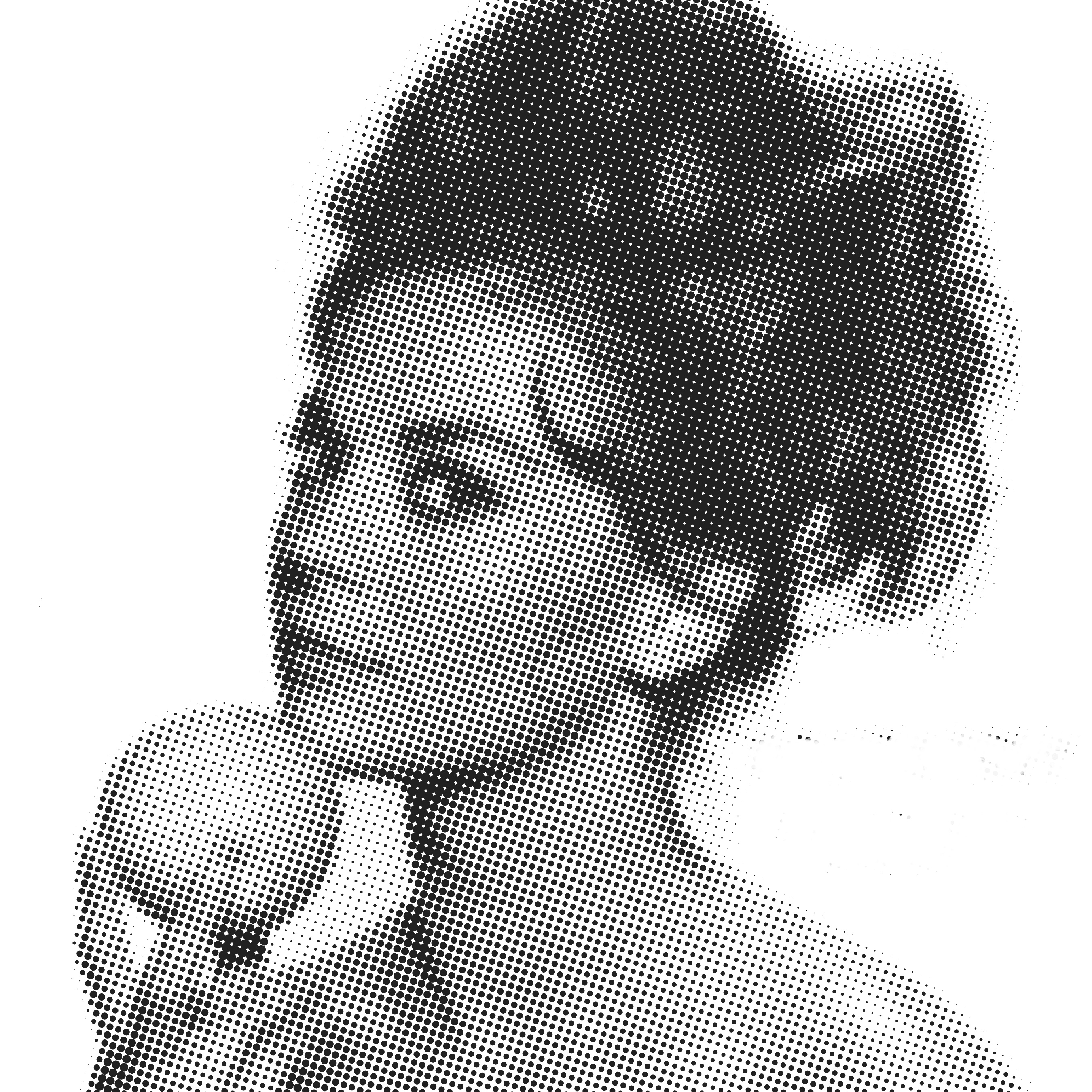

Here a quick, rough test of the halftone philosophy, this is the original image and the halftone version. I don't see why it wouldn't work.

I tried to make them a little larger so you could see the idea here, otherwise they'd be too small to see and you might not understand the philosophy of laser engraving a halftone on a tumbler
netsol
it's actually a technology that has been in use for over 150 years.
The first printed halftone photograph was an image of Prince Arthur published on October 30, 1869. The New York Daily Graphic would later publish "the first reproduction of a photograph with a full tonal range in a newspaper" on March 4, 1880 (entitled "A Scene in Shantytown") with a crude halftone screen.
