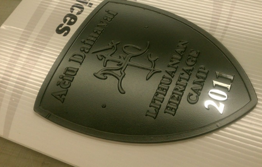

initially was going to engrave/route this project out of 1/2" aluminum, but our router has been bogged down with work this month, so this donation plaque went from "sure, we can do that for you!" to "%^&*, how am i gonna get this *&(% done in a DAY?!?"

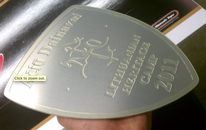

photopolymer to the rescue!
was able to salvage a chunk leftover from our last batch of ADA signs, exposed with rubylith, and came out like a charm! (first image)

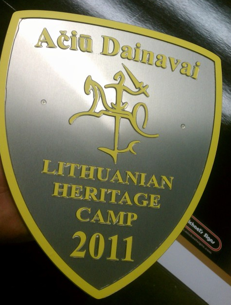

next headache. no time for two coats of paint, nor the drive to mask, paint, peel, mask, paint, peel, clearcoat. We sometimes screen our copy, but i wanted a chrome finish for the lettering.
solution? laminate chrome vinyl with paintmask, cut, and apply. (second image)

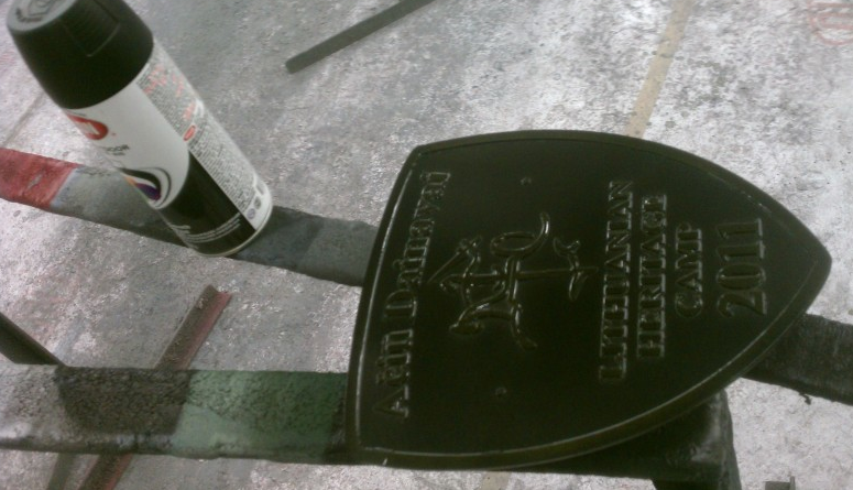

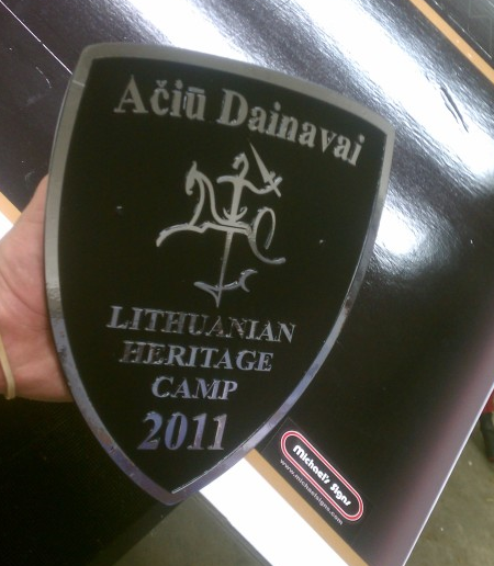

two coats of Krylon Satin Black, with a bit of texture to coverup how horrible of a painter I am (third image), and I was ready to peel off my mask 10min. later (fourth image)
going to add a couple coats of clear to seal it all together, but the finished product looks pretty darn good for a 1hour-flip!
