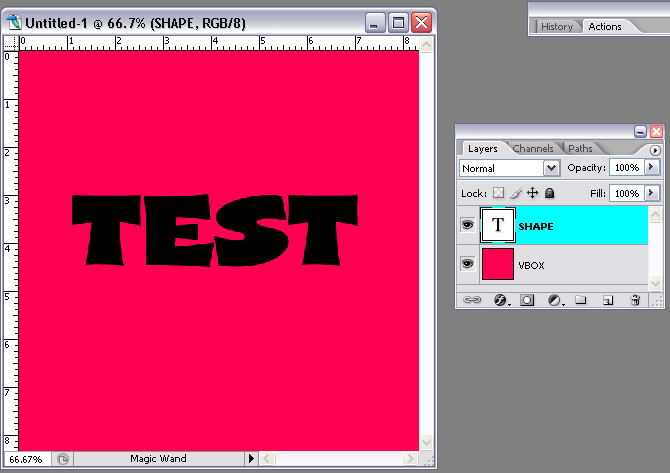

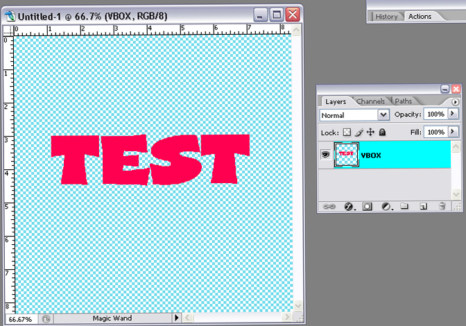

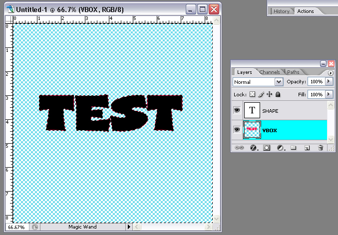

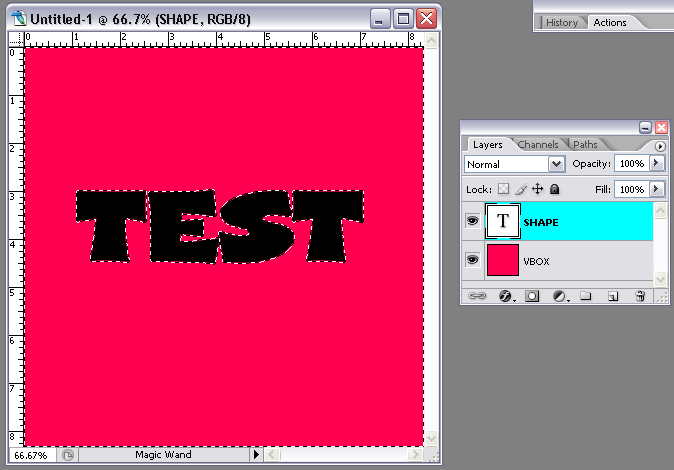

I disagree and just completed what is described. See screen shots. Please not layer order and understand that I just painted the VBOX layer red instead of importing a fill file. No vectors, no masks, no smart objects, no rasterizing of type.
  • Enter text on "SHAPE" layer.
  • Fill VBOX layer.
  • Select SHAPE layer in Layers palette and Magic wand select the unfilled area.
  • Select VBOX layer in Layers palette and press Delete on keyboard.
  • Deselect all and drag SHAPE layer to the trash.

Bear in mind I was following your approach. I normally do it slightly differently. That being I make my selection by Control Clicking the icon on the SHAPE Layer palette to select the text and then do an Inverse Selection from the Select Menu. I just tend to think it's a tighter, more accurate way to do the selection.
