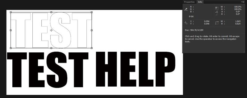

What i am trying to accomplish is a box around text without having to convert to a work path.
Create a document in photoshop.
Create a text layer with whatever you want.

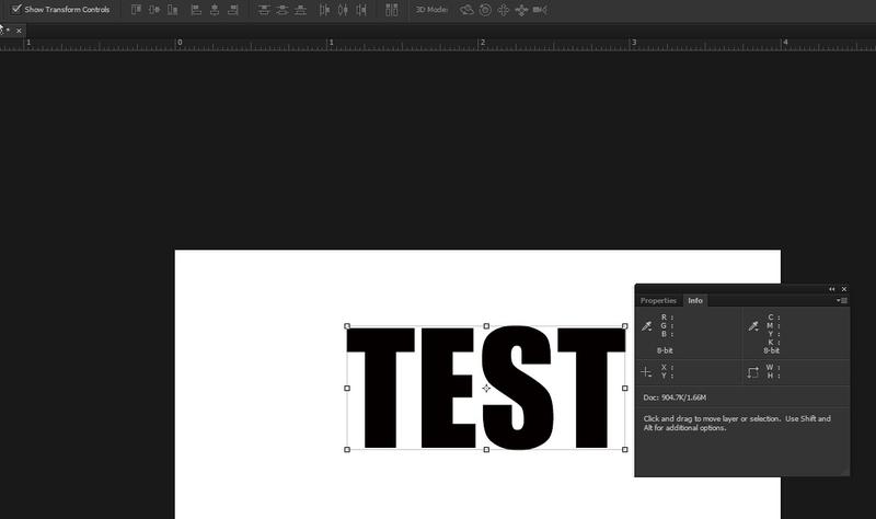

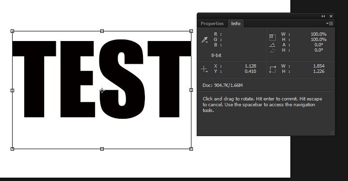

Now press CTRL+T this will give you the free transform box around the word. Well the size that is shown in the info box is not actually what size the text actually is b/c it also has the wasted area around the text for the transform box.
You can check on the Transform Box controls but this will not show you the size of the text.
Now you can always create work path of the type under the type menu.
Now when you create a new text layer and you have already converted your last text to work path. Anytime you press CTRL+T for the transform box it always goes back to the work-path no matter what????

I am designing in photoshop but when it comes to text it is miss leading unless you convert type to work path. I dont always have the need to print my solid color text from photoshop so i would like to use If you convert to a work path then it always defaults back to only that work path anytime that you press transform or CTRL T.
For instance i made some simple text in photoshop on a wrap but there was not a need to print it b/c it was white. If i try to recreate it in flexi or illustrator i do not get the correct size from photoshop b/c the transform box information it gives shows the text to be larger than it is b/c of the blank or empty area around the text that the transform box uses.
