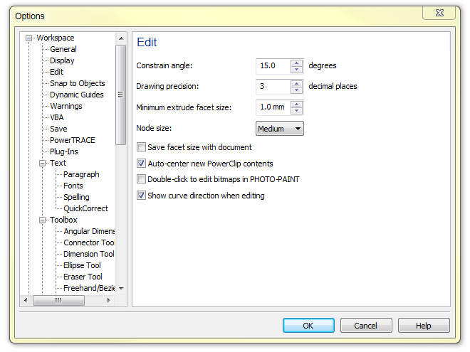

Try making you handles larger see attachment as you can see I have mine set to medium.
You will find all this under Options "Ctrl J" Edit.

Ooohh.... didn't know you could do that! Definitely a to-do item. Thanks!
