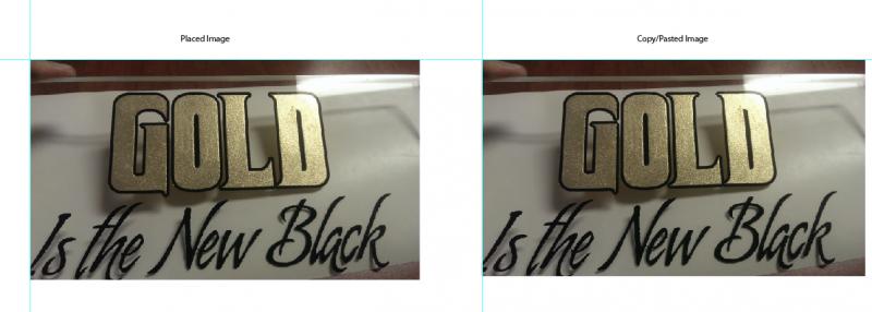

OK, just did a test on this. I placed an image off my desktop. Then I opened the image in photoshop, selected all, copied... then went into Illustrator and pasted the graphic. Then I saved the file as an .eps to the desktop. Then I proceeded to delete the original jpg from the desktop. Then I reopened the Illustrator .eps file.
As I thought, there was no change. No shift and no pixelation.

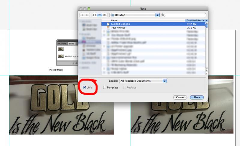

If the imported file is LINKED to the source file, editing the source file and then opening it in Illustrator can make it shift, particularly if you resized the original. If the imported file is EMBEDDED in Illustrator, editing or deleting the source file will not have any effect. You can look at the LINKS window, click on the the art, and it will tell you if it is linked or embedded. Don't know if I am on the right track with what you are talking about though. :smile:
Biker Scout
OK, the only way things to get messed up in Illustrator on a "Placed Image" is if you have the "LINK" button checked on your File:Image:place dialog box checked. Otherwise the default is to embed the image as part of the artboard.
Biker Scout
Once you have a linked image there is a "Placement Options" setting that allows you to have the image honor certain image bounds settings. This may be where you are experiencing image shifting.
