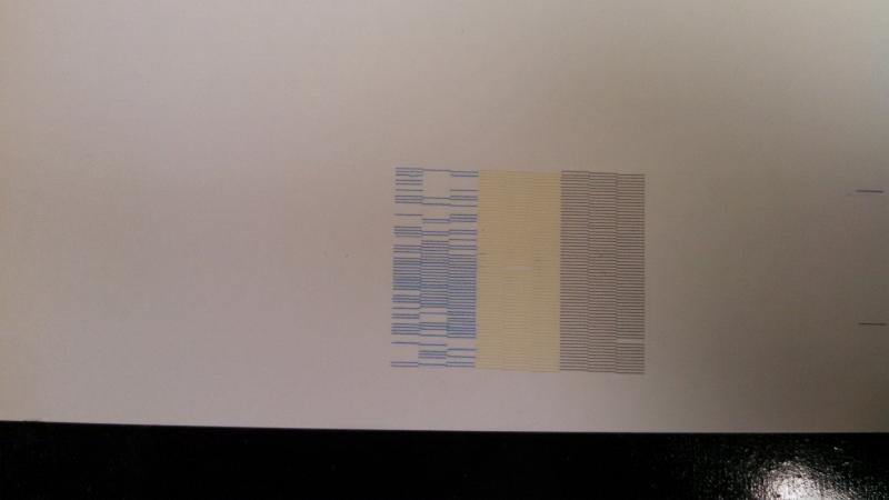

PLEASE ADVISE. Magenta completely absent from test draw on UJF-3042.
ghayden
When I run the test draw, the magenta is completely absent and the blue is pretty spotty as well. I've tried multiple extended nozzle washes (40-60 minutes) and hard cleanings with no real improvement. Any responses would be appreciated. Thanks!
sbrown1616
Usually it's a bad damper when there is no ink shooting and hard cleanings do not help. They are kind of a pain to change but it can be done and it's not too difficult. Let me know if this was your problem.
