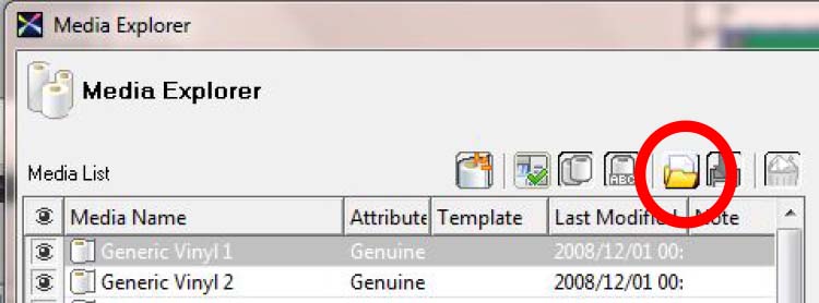

The RML installs into Media Explorer. See the image for the icon.
Thank you VERY much for helping me...
I am fine up to there and that is where I get lost...after that...
From what folder in my computer do I find those files to import and what are they named...???
That's the main problem, I don't know exactly what to install and from where...???
