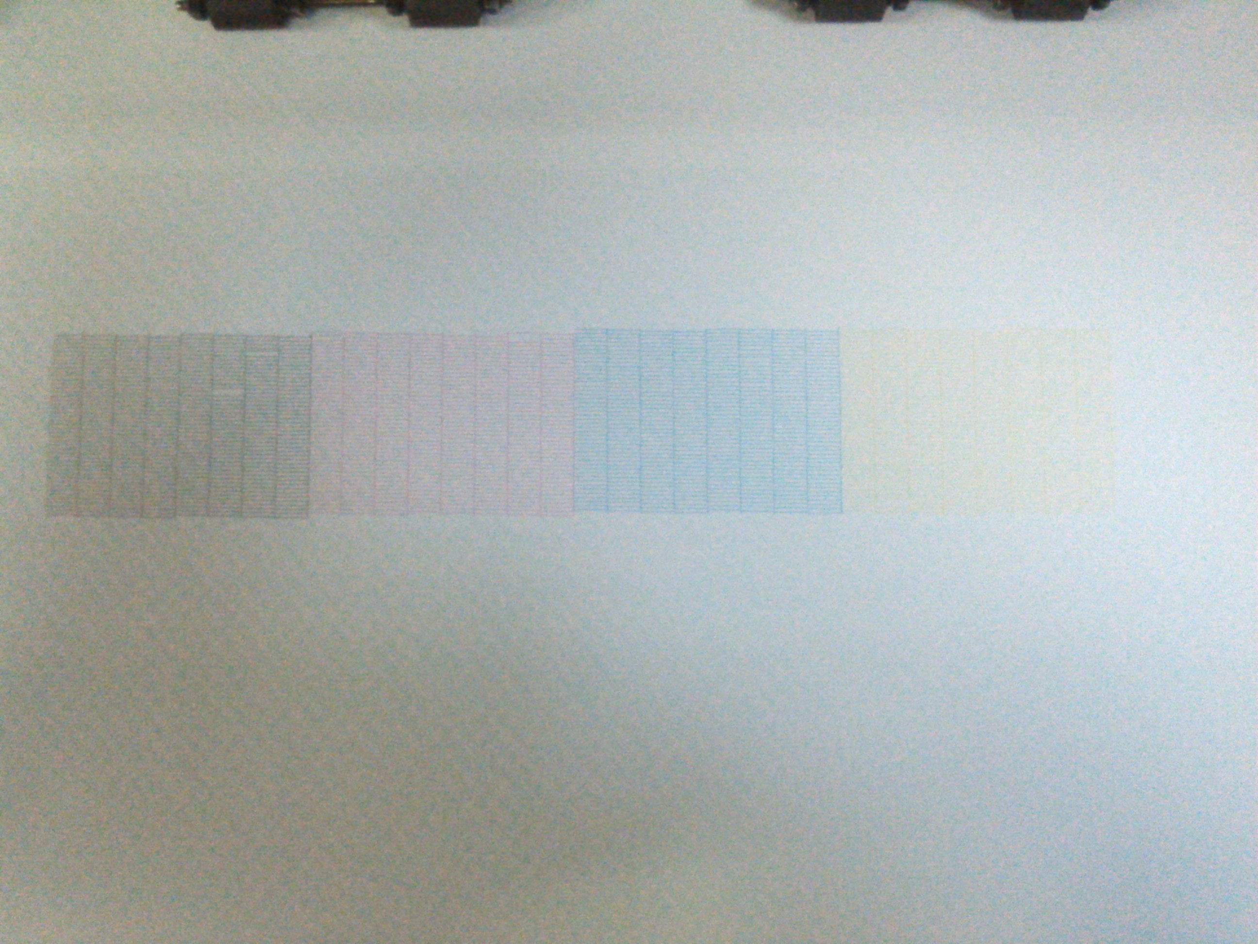

The print test have a few nozzles missing and deviating - see picture IMG_20170202_112104.jpg

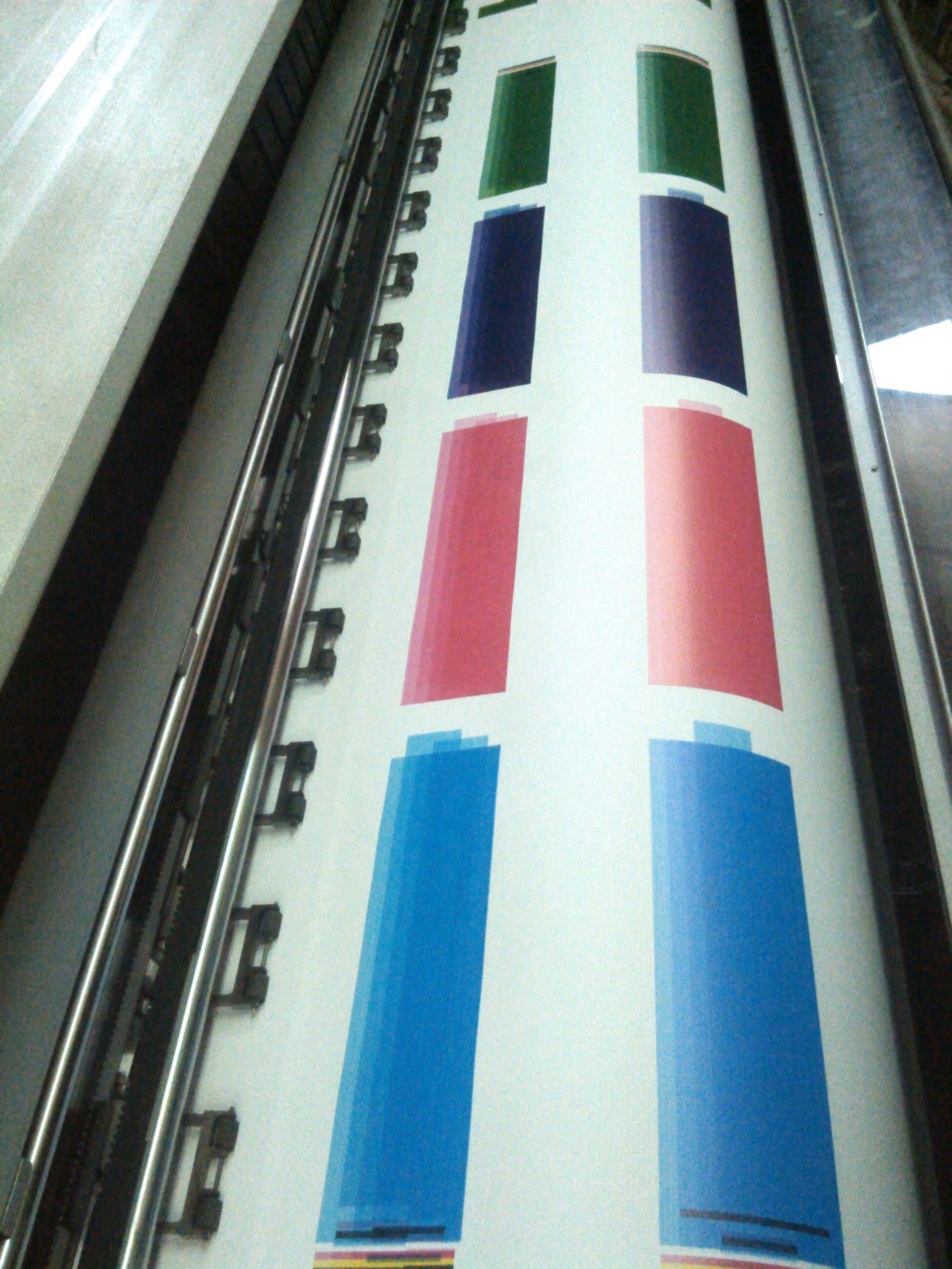

The problem is when I print on 720x720 less than 16 passes - 8,4,2p - I have the colors to get shift, sometimes don't have it, but till now i have it much often. First I think that it is by the magenta chanel but I have mistake. I make some tests.
I print a square 20x20 cm - 100%c 100%m 100%cm 100%cy

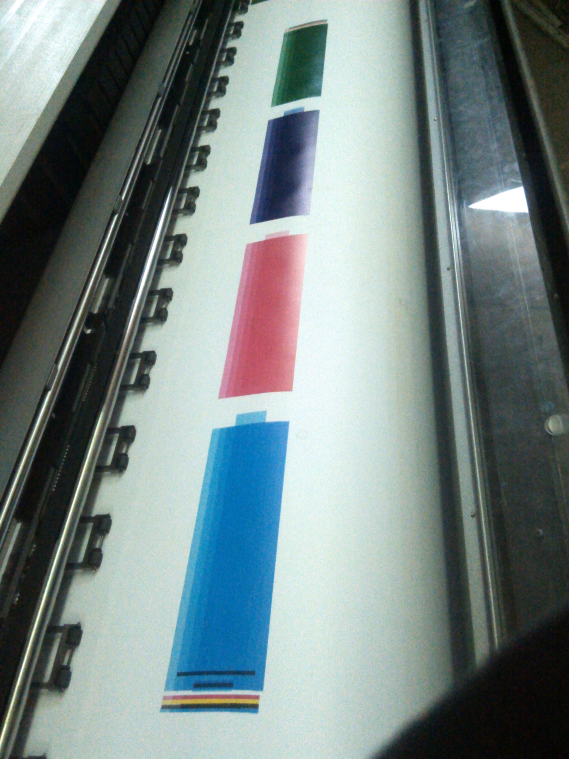

At the third print I don't have color shift but it is slow

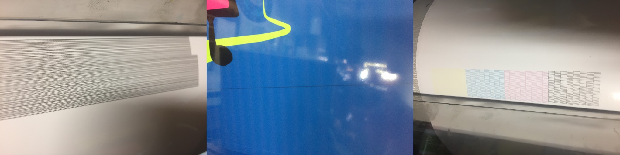

Also from some time I see that at 16p it did't shift but it make cyan overspray very bad -> IMG_20170201_200057.jpg
That is only if I print cyan or cyan +magenta like on picture, and one time with yellow(green)

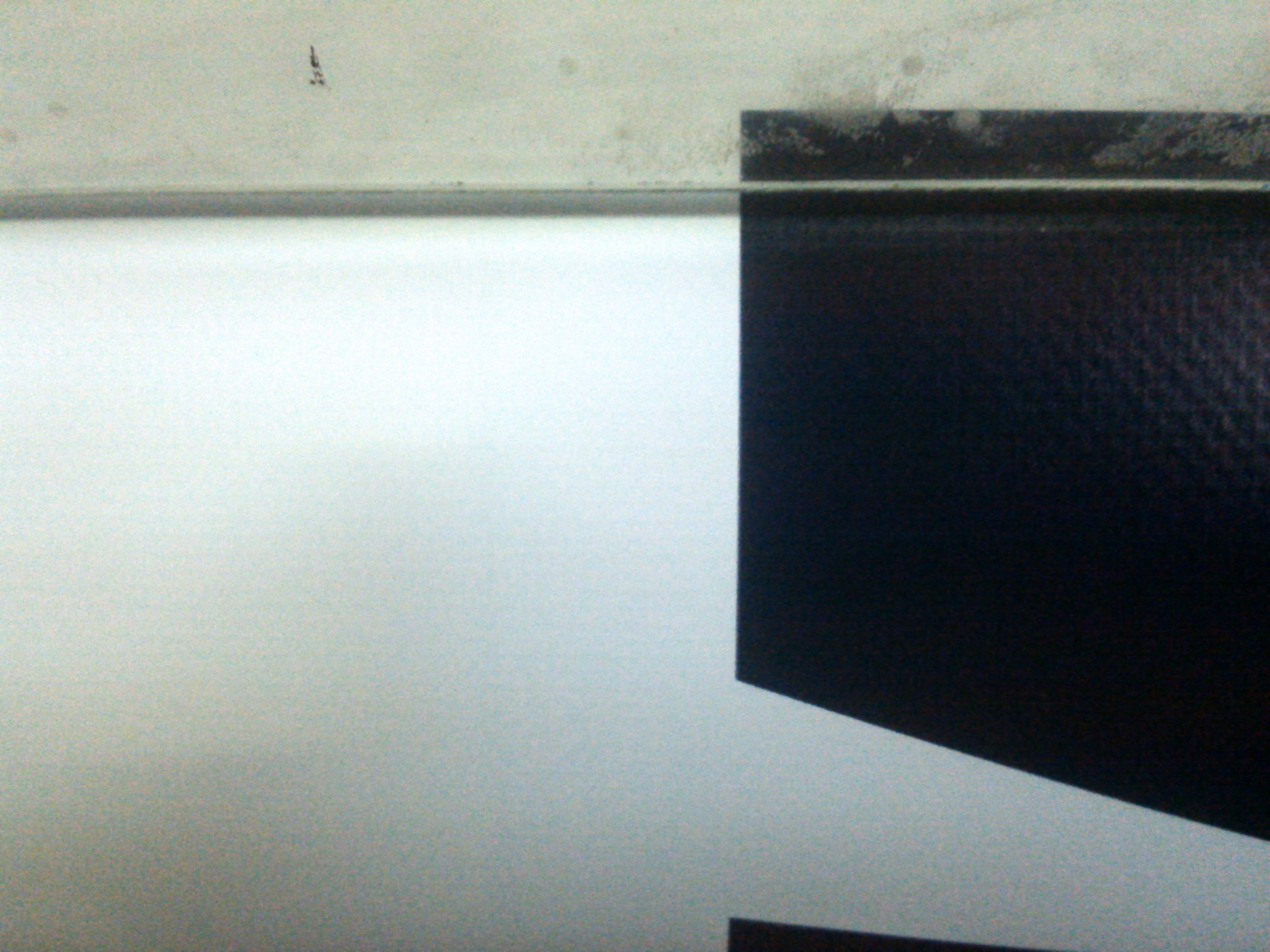

2.The other big problem I have is I have is that on high speed printer don't print the passes in straight and after print align!
For first problem first I think is dying head/ first magenta,after that cyan/ but I make more tests it make it with black and yellow also. at less than 16p.
I think It will be slider or can be more bad motherboard??
The second I think need new encoder strip is needed or?

Boobanke you mean you also have alignment issue. It was ok before 2-3 months but now on fast speed I have a 1mm difference. I didn't change anything till now but I can't align to go straight on bidirectional.

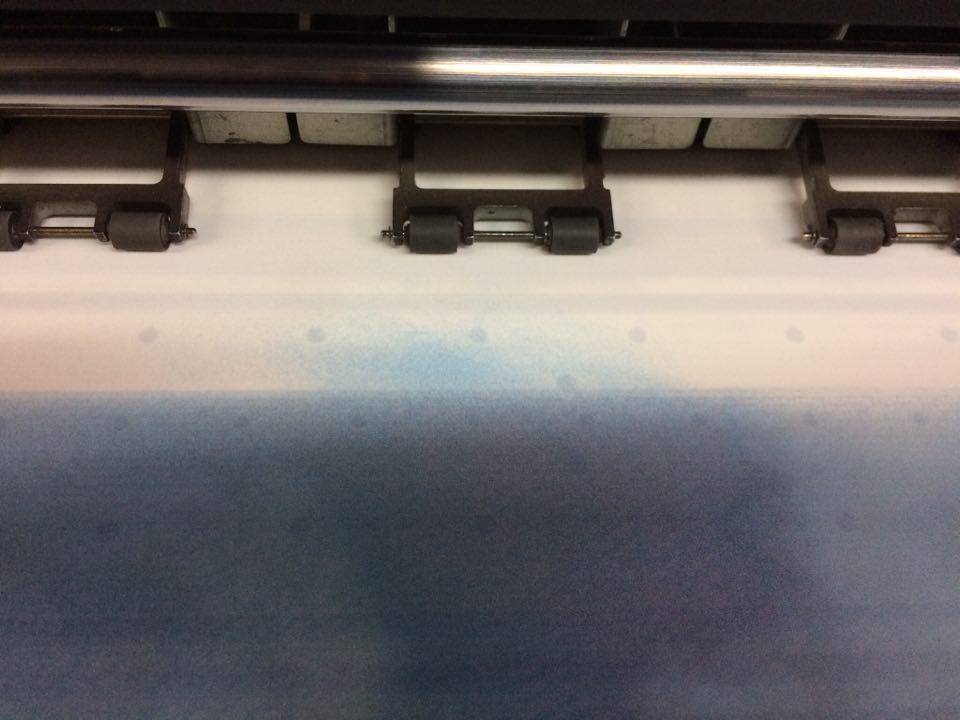

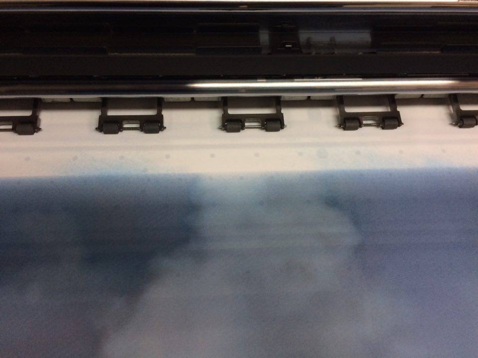

Today I print blue sky 2x1,4m and in the end where was much darker blue it overspray on them in other part of the image I don't have it. 16650139_1619160848110788_604440423_n.jpg 16559305_1619160878110785_629260183_n.jpg - 720x720 16p normal speed
I think it is cyan head or the slider is bad. I wait tech to come and see but for now will have to work somehow.
