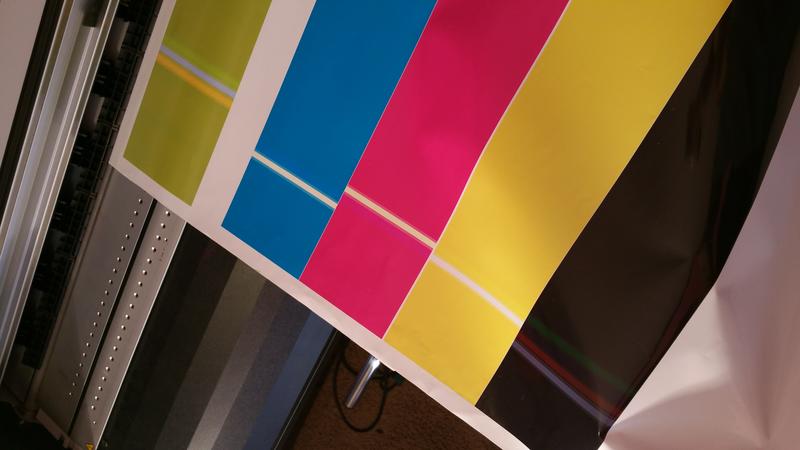

Hello i have a mutoh vj1204 that i have had for a few months trying to fix it and have been through it with this thing. When i got it 2 of the colors were completely plugged as it had been sitting for a while but was barely used. I got the head unplugged but it wouldn't put any ink down (i had posted in someone elses thread while i was going through that lol) anyway my old boss has the same printer and I had replaced the printhead in it before I left working for him so I asked him if I could borrow the old head I took out because I knew it at least printed something just to make sure that my printhead was the problem because I had already gone through the main board and check the fuses put it back together with that other printhead and it printed at about 75% on all nozzles besides the yellow it printed perfect so blah blah blah I bought a new printhead and it prints good besides it has these weird vertical lines printing in it in different places depending on what I print, i have about lost my mind trying to look up and or research on here what it could be now I'm asking for help any direction would be greatly appreciated. I've seen that it could be something to do with the head rank but I honestly just needs some professional advice at this point please please help has all of my eggs are in this basket and I need it to work 100% so I can take care of my customers and take forward steps. thank you in advance and sorry for the novel also I have replaced all of the dampers the wiper the capping station the spitoon pad and had data cables manifold and new Ink throughout this process as well

Normally I would lean towards a dirty or damaged encoder strip but the pattern doesn't match a typical encoder issue. There is a possibility that you have an electrical issue with the cables and/or head but I think the real problem is that the head is not meant for that machine. There are about 10 different versions of the DX5 print head and they are all manufactured by Epson. Everything internally is the same but they alter the circuit boards so that they are only usable in certain machines. The person you bought the print head from probably sold you a DX5 head for an Epson desktop printer which is designed to put vertical lines in your print after it prints a certain width. So if the head was designed for a 17" printer, it will print lines if it detects it has gone more than 17". From what I have seen, the pattern your printer is printing could be due to the version of the head being wrong. I haven't seen enough of these print heads in these machines so I am not 100% but I am fairly certain this is the case especially if the cost of the head was less than half of an OEM one.
GAC05
Quit buggin' me
I think Vander is correct.
You might want to search for a DX5 printer head decoder card.
See if this is your problem & solution.
