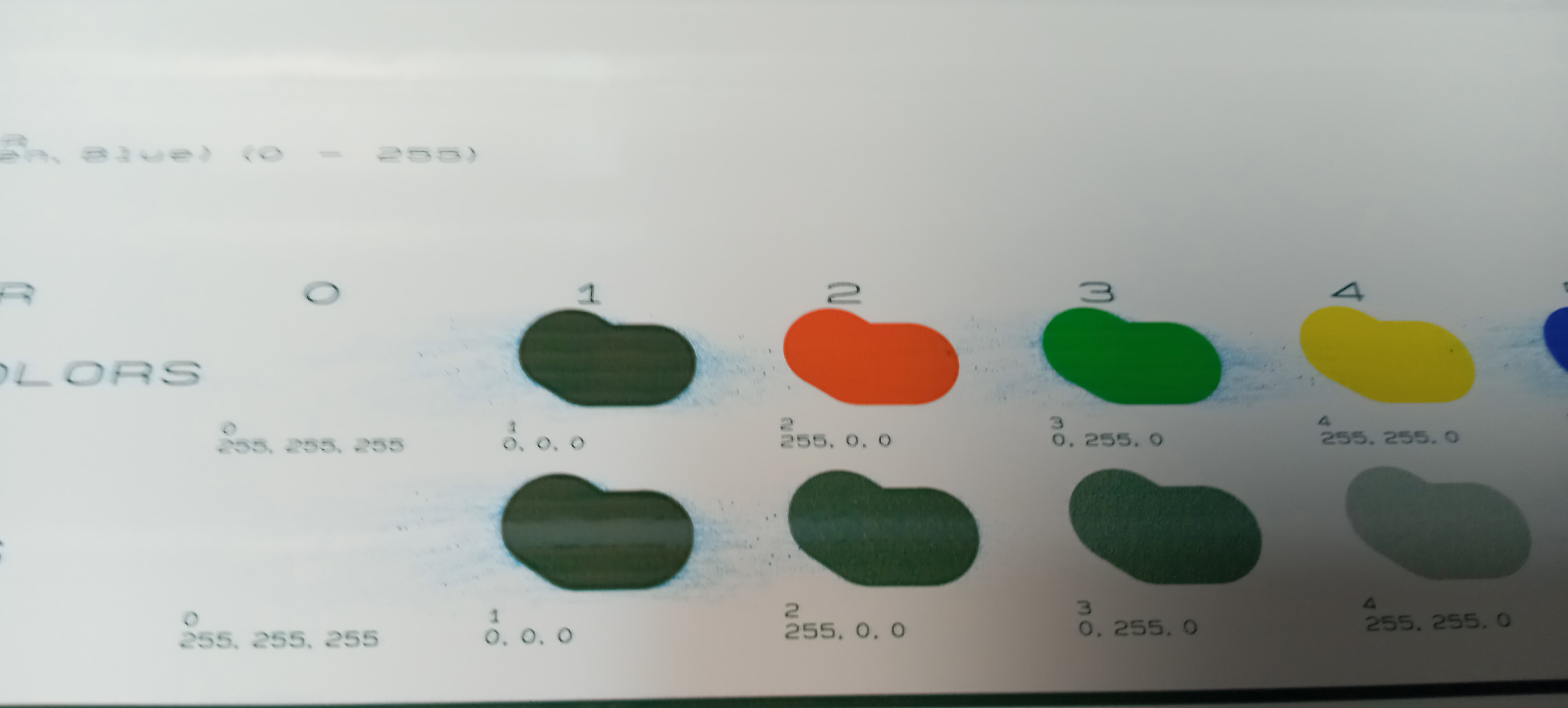

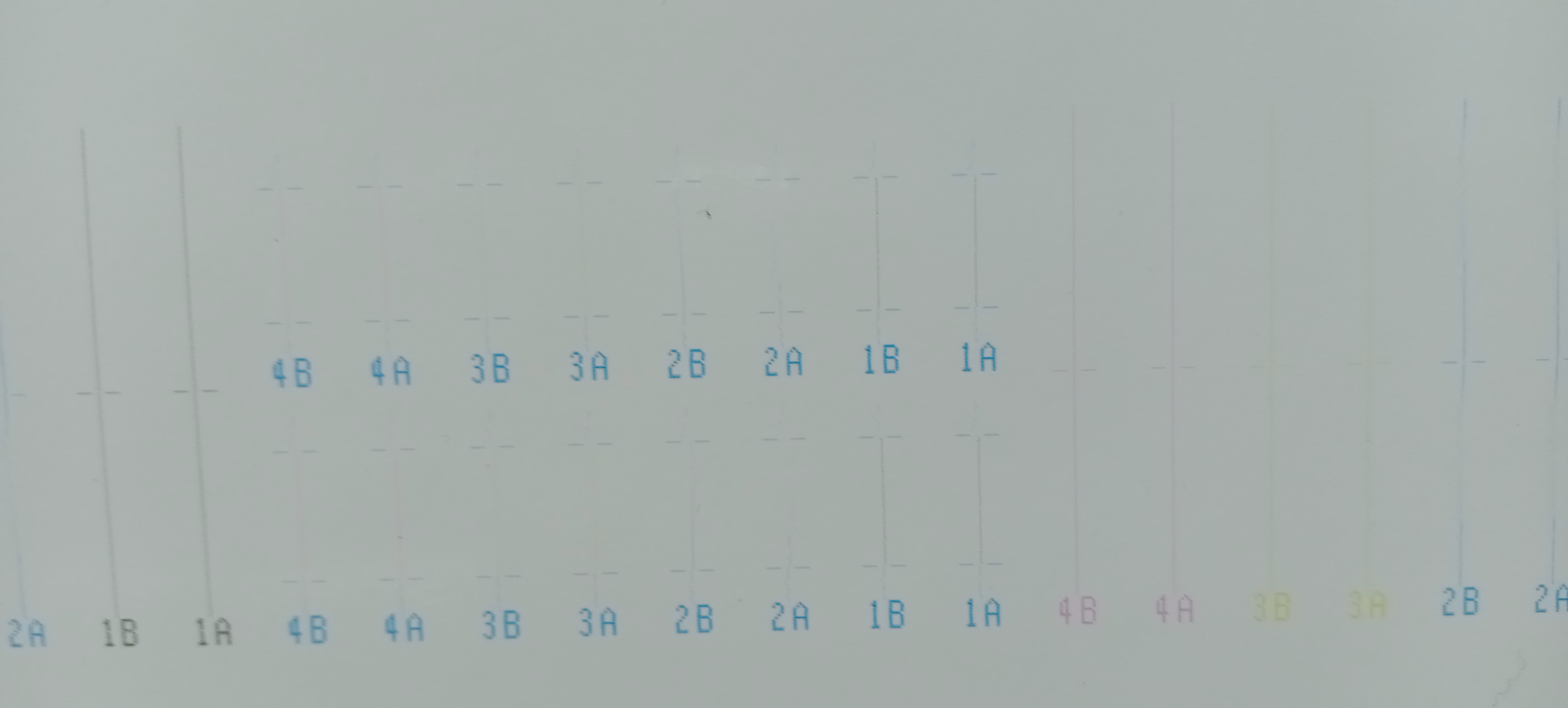

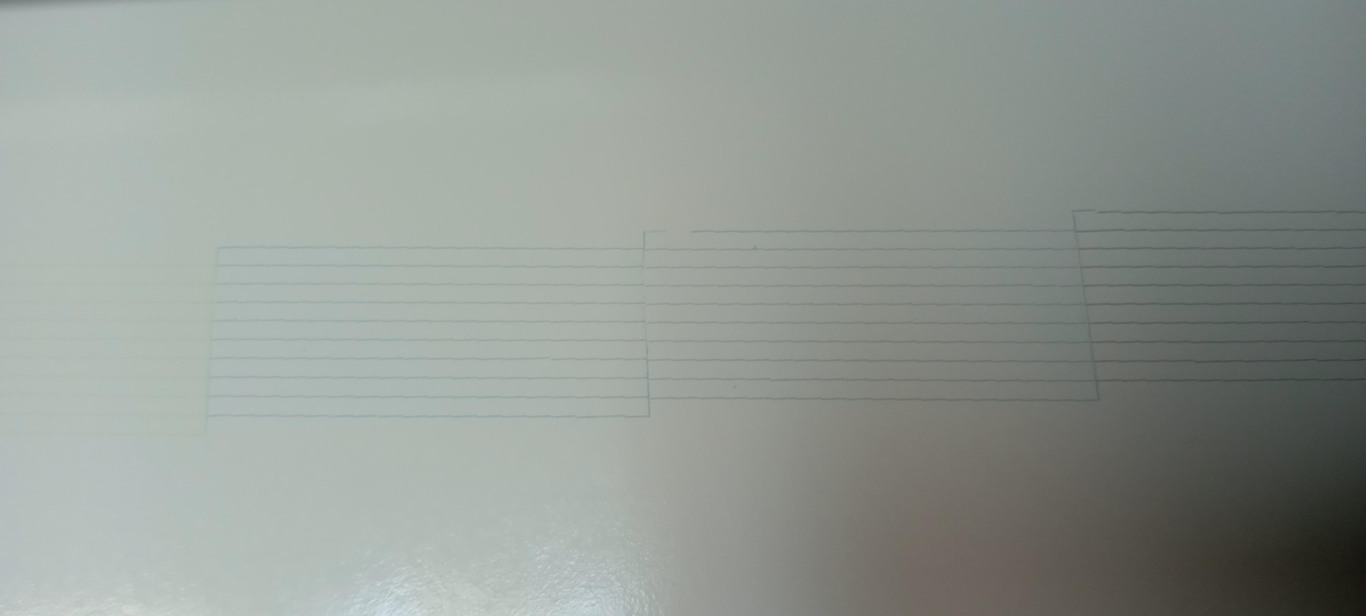

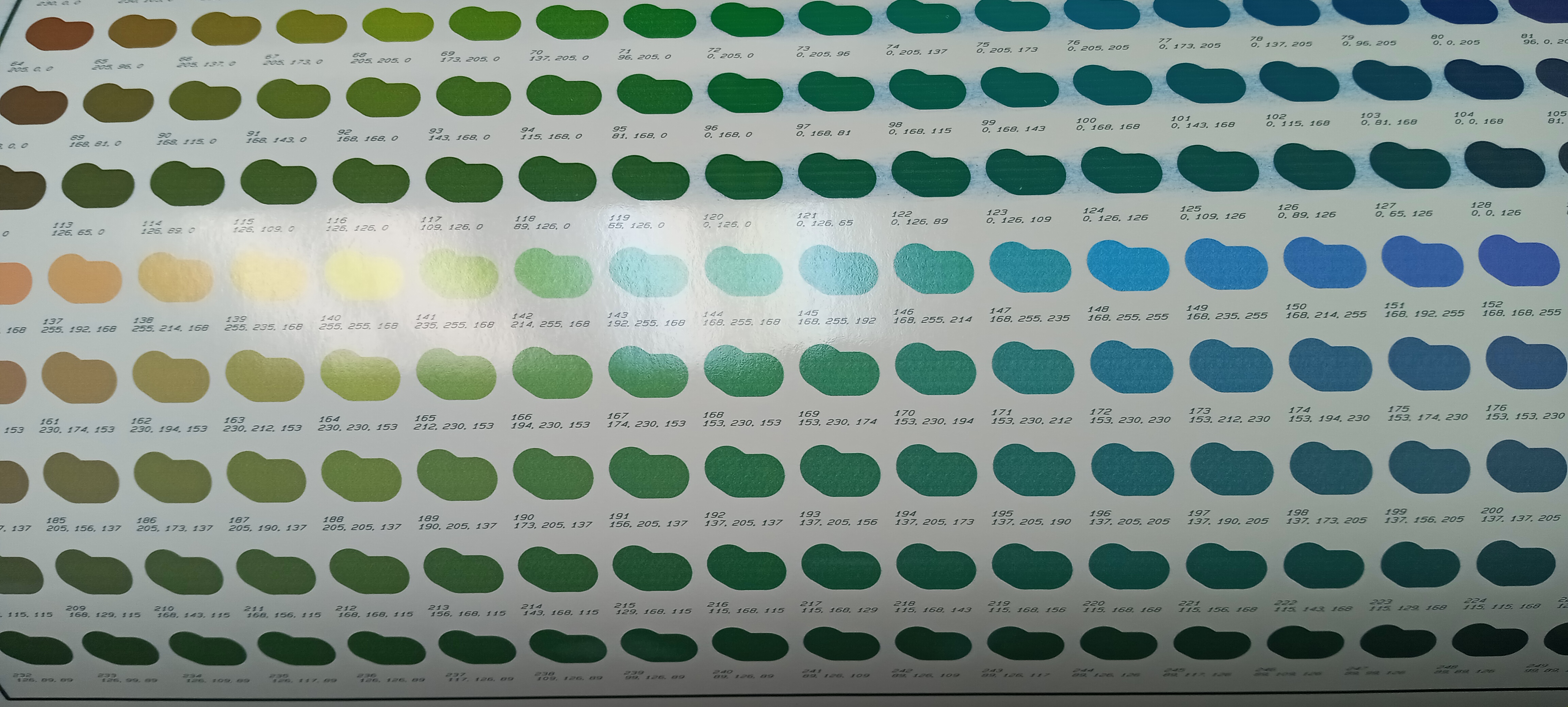

I have a VJ 1204 Mutoh printer and I am getting some lines in my print but the main thing is when I do a nozzle check my cyan pattern is not straight, all my other ones are fine and it looks like it has overspray only on certain colors it seems. I have attached some pictures to help show what I am talking about. I tried to do a head adjustment and alignment along with cleaning of the fence, cleaned around the head and let it sit over night on a lint free towel with head cleaner, I replaced the cyan dampers. Cleaned all around the capping stations and wiper blade. I replaced the maintenance station about 8 months ago. PLEASE anyone who has any ideas let me know. I have been for 5 days now and I'm at a stand still please help

Hi, I know this may sound crazy but how old is the ink especially the cyan?
I've just been the through the exact same problem with a Mutoh XPJ661 but in my case it was the magenta it was out of date by a couple of months, when replaced and line flushed it all came good.

Hey Karl, I checked the ink and it is expired I will change them out tomorrow and let you know. I replaced the dampers and now just trying to get the air out. Thank you very much for the response, I'm just out of money and ideas but again ty for responding to my post. You are the only one that did and I thank you VERY much. I will keep you updated.
