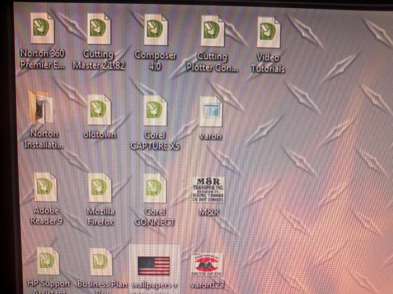

I just bought corel x5 from corel. And installed it fine. But now only corel works. All my other programs on desktop and startmenu have corel logos.and when pressed only corel opens.... I also tried right clicking my omega and pressing open with and then choose default program. I chose omega. And all the icons on desktop and startmenu chamged to omega icons. But when i click on one nothing opens. Oh and my norton says all is good.

Ayayi. Now im doubting norton. A couple days ago. my year ended. And when i updated a day or so later. It said i had a trojan on the first scan. Arghhh. So it said it took care of it. But could that be it? When i right click on omega and press open with and then choose default program. I click omega and then all the icons change to omega. Also omega wont open. I'm screwed! Also the diamond plate was from omega's free sign fills cd that came with the purchase.

first of all I would suggest a system restore is in order. Your problem lies within windows file associations which dictate which windows programs open which types of files. A restore to a point before the corel instalation should resolve your problem. after that I would remove corel if it is still an option and reinstall the program using a custom install option and then reading each step very carefully so as to avoid associating corel with all graphic filetypes thus eliminating your current problem.
don't ask me how i came by this pearl of wisdom and I won't lie to you and blame it on someone else,or a piece of innocent software,.....

Thanks. I stayed up late googling this topic. I'm not the only one. Im also in communication with a corel tech. I'm pretty sure its a windows problem. But when i uninstall corel. The problem goes away. As for the custom install i did that. I did choose corel draw. Photopaint and connect. A font program and another file that said its for helping importing and exporting options. Some peopke say system restore. Which i will do in a bit. But that still doesn't work for some people on google. I also read that i should clear my icon cache. Where that is? Who knows.

Hey. I didn't do a system restore. But i created a new account made it the administrator. Transferred all my design files and deleted the old account. Its now working perfectly. I hope this isn't a temporary fix.
