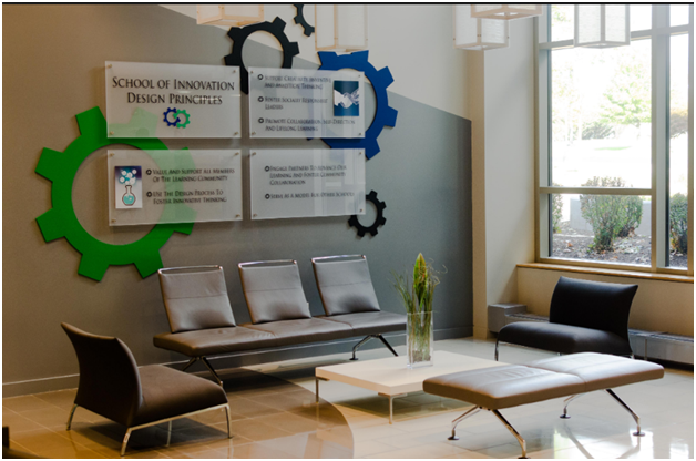

I need to make this... would this be frosted glass vinyl on the back of clear acrylic with cut vinyl / digital print cut images on the front?
If I used 5/16 plexi, how would you recommend cutting it?

Find a plastic distributor in your area that will cut it for you. They will cut it to the size you need and give you a good edge so you can polish them. Install frosted vinyl on back and put a pad down on your work table so it does not scratch the frosted. Apply cut out copy and prints on first surface. Be careful drilling holes for stand offs so it does not rip the frosted vinyl. Or you could drill your holes before applying vinyl to back to avoid tearouts drilling, I do not know how meticulous you are about things. Or you could put the vinyl and prints on first, drill holes and wet apply frosted to back.

Get P-95 clear acrylic because it is frosted/matte on one side and looks just like your photo and then use cut vinyl on the front surface. No need for frosted vinyl in the back unless u want more opaque of a frost.

I like to use green edge acrylic with polished edges. Then when putting etch vinyl on 2nd surface cut in about a 1/4" around the edge being careful not to show razor cutmarks on overlap. Gives it a look of glass and more custom.
I only use the p95 and ones like it for frames of pictures to reduce glare. And if you scratch that p95 on the etch side you will not be able to repair it.

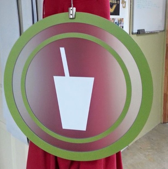

here is a ceiling hanging for a cafeteria
P-95 / P-99 is not as opaque as the frosted film, this will come down to how close you want to be to the image.

Is that frosted or P95 in your image?
