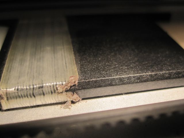

i am from algeria i have printshop and i use designjet 5500ps uv ink i had problem since 4 weeks ago i got reseat message on cyan and light cyan printhead error message is 5508/ 5506 i tried to reseat them but nothing change i cleaned the contact also no change i bought new cyan and light cyan printhead the machine accepted one printhead the cyan printhead and keep telling me to reseat the light cyan printhead
so plz guyz help me with this coz where i live is very hard for me to get ink and printhead and part for this machine easly plz help me i am hopeless here
second thing i sespect is when open the door of the plotter i saw that the trailing cable is not normal
this is a pic of the trailing cable thank you hope someone will help me with this

I would replace that trailing cable first!

hello my friends i fixed the problem and it was a very simple solution i just cleaned the encoder strip that is it
