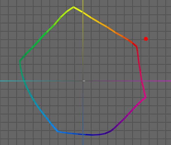

Pantone 185C is likely to be moderately out of gamut, but you should be able to get much closer than 10.3 dE if:
1) Your ink restrictions (primary channel ink limits) are reasonably set.
2) The machine is in a linear state.
3) Your ICC Profile is accurate to the present behavior of the machine.
4) the RIP is recognizing the spot color.
I checked on one of my HP Latex machines running a standard calendared vinyl (3M IJ40) and the predicted dE 2000 for that color is 4.3, which is a good (but not great) simulation of the Pantone. It's definitely out of gamut as seen in the image.
Paul
