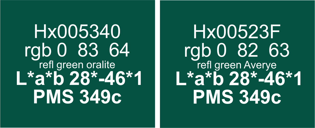

printhog
Here's color measurements from calibrated device for Avery and Oralite green reflectives.. they are nearly identical due to federal highway specs.. Hex color is Hx . color measured at d50*2. Call outs are a generic cross reference from L*a*b readings. The L*a*b callout is supported in most design apps.. Closest pms color is quite far off in cmyk space as it requires color conversion. The pantone android app says 330c is closest based on HTML hex code.
