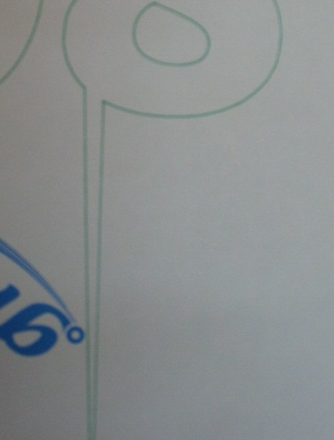

Just got a pnc 1000 up and running but having hassles with the cut.
Part way through a cut it will shoot of at tangent to the edge of page and then return (V)and continue cutting.
In this action it will miss 4-5mm in the actual cut path.
I will get an "Error 2 Wrong No of Parameters"
How am I creating an wrong No of Parameters?
Anyone throw any light on this for me?

A little more info for you all to work with.
I have attached a pic to help explain the problem I am having.

OldPaint
Error 2. Wrong No of Parameters
with a pnc-1000 you will get that all the time. the problem i see with the drawing is you got a NODE problem in the cutting program. its reading what the computer is tellin the plotter to do.
ZOOM in on the "g" and see if you dont have a wild NODE. REDUCE NODES and this should go away.

I agree with OldPaint answer, I had a PNC1000 for the last 13years and was using a driver called signpost to cut and had no error messages. Last year this Signpost software had stopped functioning because it had a dongle. I managed to download the driver for the PNC 1000 from Roland site and started cutting direct from coreldrw to the plotter and in this method started giving me this message, but it says you have to ignore it.
