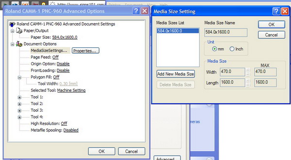

Brocko777
Kinda geared toward Cadmn but anyone else feel free to jump in!
This is my advance screen, when I go to change the length it won't let me go further than that 63" (1600mm) although I have the 23.5" (584mm) in the first media size list. I am screwing something up but cannot find it.
Any clues?
Thanks
BRocko
freehand
Maybe, just maybe - not shure, you should change it first in control panel, under printers-printing preferences...
That i have forgotten.
