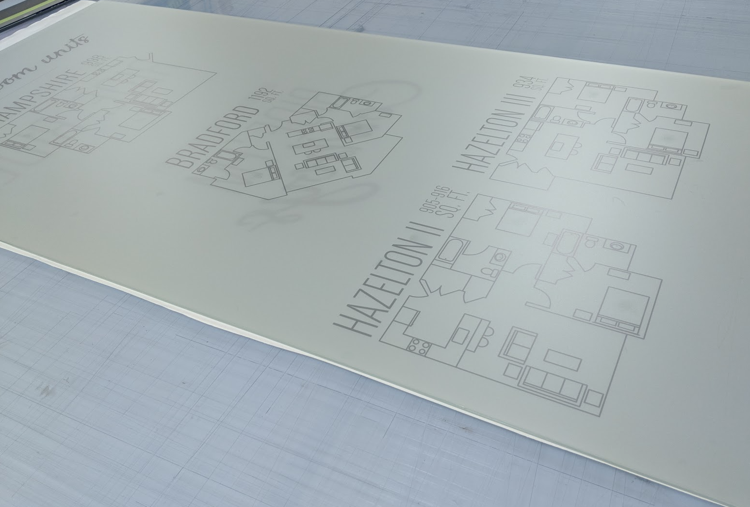

Mactac is much easier to use -- way less tacky than 3M (and less expensive to boot). I always digitally print the negative space on frost vinyl b/c it's way too difficult trying to find the cut edges for weeding. Just a light 15-20% black does the job, and it still looks fine even if the plotter gets off a tiny bit.

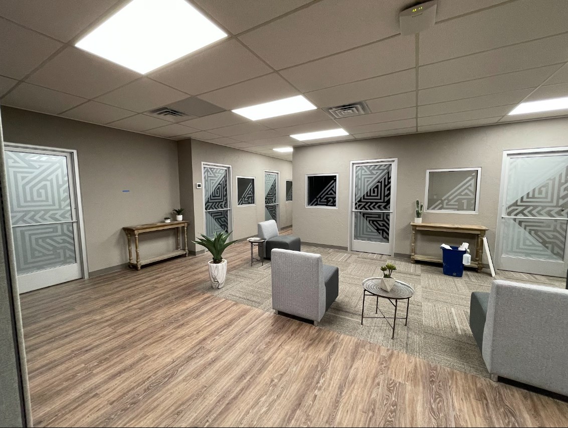

It definitely helps on detailed jobs like in the first pic (not yet weeded)... or when you have a ton of windows to do like the 2nd pic (1.5 rolls of 48" Mactac)
Oh that's a cruel amount to reverse weed and install. Hope they paid through the nose for it!
gnubler
No kidding! That looks like a nightmare to weed and also apply. Lots of little pieces that might not release from the premask, and disappear in the mess.
