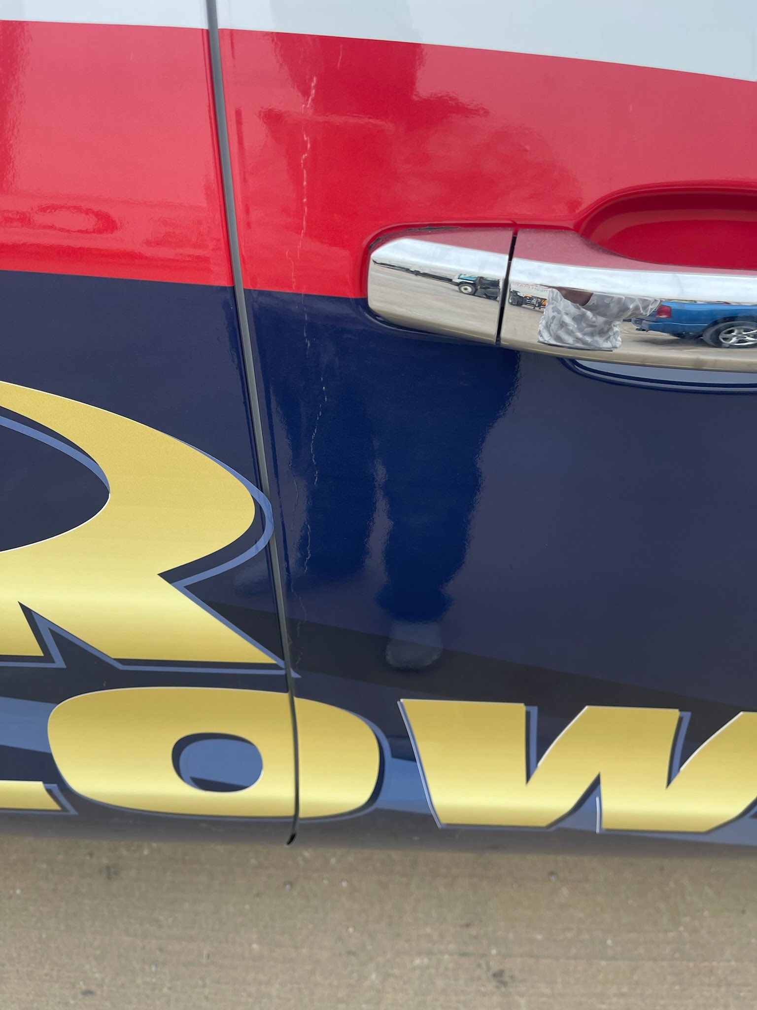

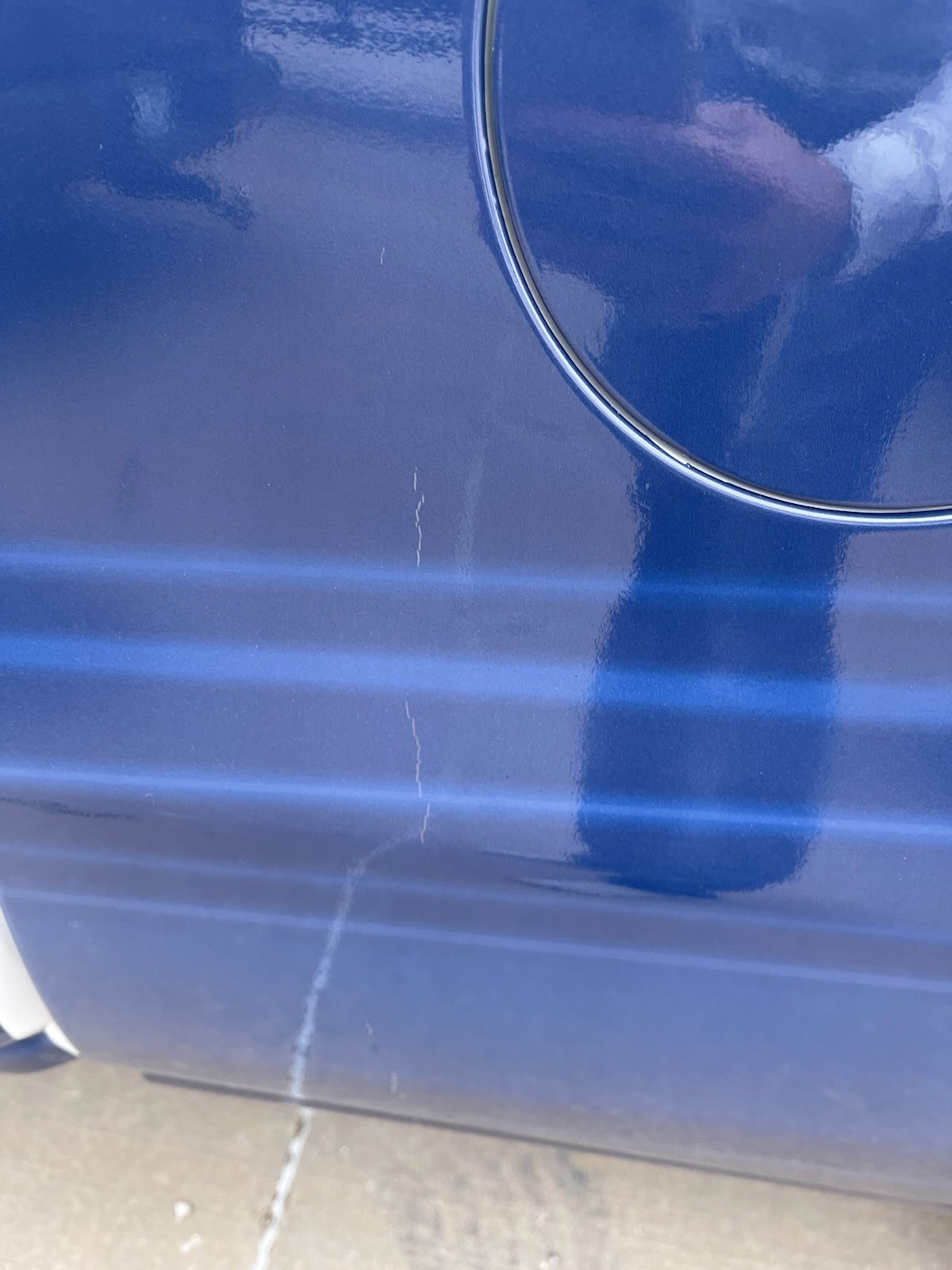

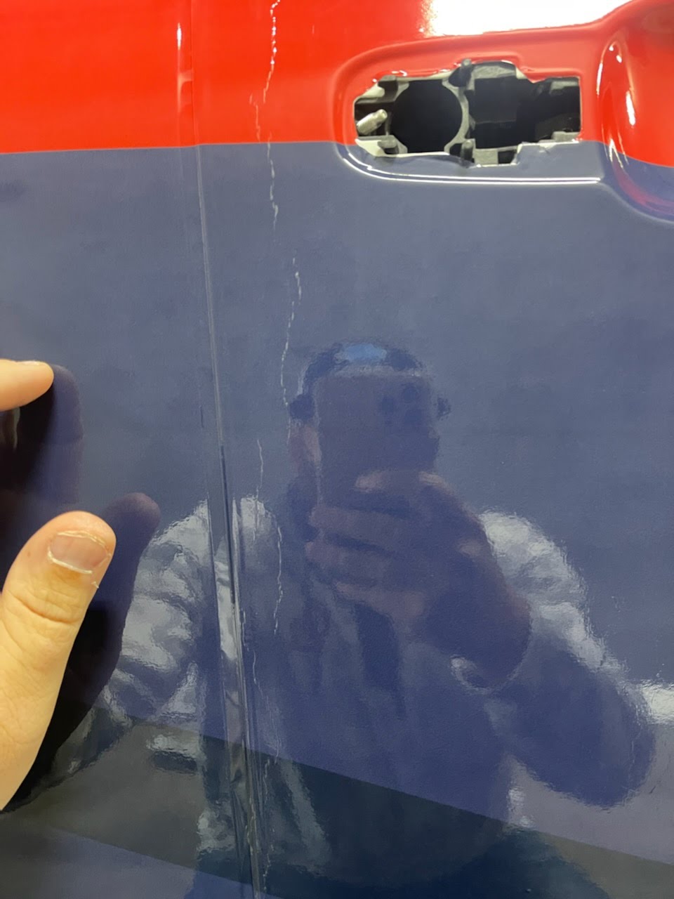

Had a weird problem come up this last week where it looks like the premask on a wrap caused the laminate underneath to bunch up and separate from the vinyl in areas. This is IJ 180cv3 with 8518 gloss lam and latex ink.
I haven’t had any issues with 3M and latex delaminating before, and it’s perfectly fine on the pieces of this job that were not masked so it has to be the premask.
Has this happened to anyone on here before? I guess I just won’t be able to mask larger pieces like this anymore but I don’t see why it should be causing issues like this.

What sort of premask was it?
In my experience, no that sounds off. Now, it someone masked it, applied to that region, then decided to pull the mask from the loose vinyl, then it could have 'kinked' the vinyl as it seperated, which puts those telltale jagged lines in the laminate. Hopefully a bit of heat will take that right out...
It was Rtape.
That definitely could have been it. I had someone else installing it so I’m not sure at what point they removed the mask.
Aelin
Yeah, I would have pulled the mask to wrap the end of the door myself, since it lays and conforms better, but it would have struck me pretty quick that something was going wrong, and I at least need to tack it down to the edge to the door and pull directly in line with whatever panel the vinyl was stuck to, then you you can pull it back up and lay it however.
What was the mask for exactly?
At the top of the panel there are a couple of long, thin stripes that the mask was applied for. Going forward I guess I may need to just mask the stripes and apply them separately as decals, I hate having seams on areas like that though.
Aelin
Ah, nobody does, but ideally you would just wrap the whole door instead of doing a 'partial wrap'. If the customer wants graphics like that, I'd price the panel for a full coverage and not contour cut anything, then they may let you manipulate the art to either break the curves off or just toss them in general, or maybe they don't mind paying the extra and you can skip a whole step with contour cutting and bring home a bit more cash.
Yeah, I wish. These customers wanted to match their existing wraps that were all contour cut like this one, so we didn’t have any design freedom.
They may just have to be happy with the decal solution going forward. ‍
You think the wrinkles will come out alright with some more heat?

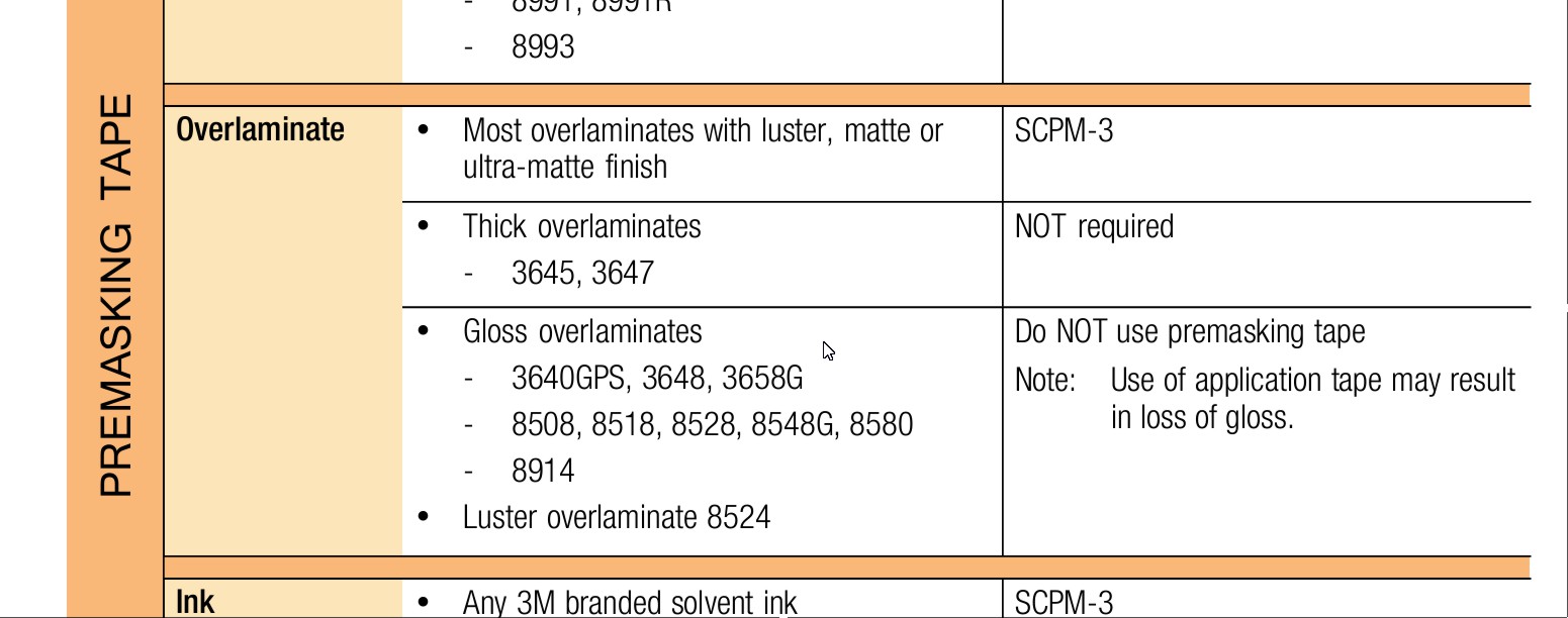

I've had this same problem on a large scale. 3M says not to apply transfer paper to their gloss lams as it removes gloss (see screenshot attached). I'm unsure if this is part of the "removes gloss" problem but I've experienced the same thing that happened to you. Sucks. screen shot.jpg
