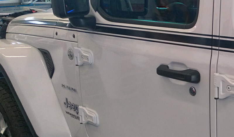

I installed striping on a Jeep, triple stripe of one color, used cast cut vinyl premasked with paper tape. Really struggled when I had to work around the mirrors, made a series of relief cuts to apply, then trimmed with a knife. Very stressful, I was half tempted to cancel the job but kept going. Would using knifeless tape around the base of the mirrors be easier and result in a cleaner cut line? Then there was a concave curve in the hood, more struggling to get the stripes down smooth and level. How do you deal with contours like this with premask? Can't use a heat gun until the tape is removed. I had trouble with the passenger side with the antenna in the way, lots of bubbles/wrinkles (see pic). I told the customer I would redo it but she said she didn't care. The whole job ended up taking almost two hours, I was stressed and couldn't wait to get rid of the customer, major PITA. When I quoted the job I told her it would probably take two hours, and that turned out to be accurate, but I feel like this shouldn't have been so hard. Any tips on premasked striping with contours? How long would a job like this take you to install?

I wouldn't have premasked the vinyl with those contours. If it were me, I would've laid the stripes down by hand without premask and would've done them individually. I've had plenty of these PITA jobs so I feel your pain!

I would have done this soaking wet with app fluid, and I would not have removed the inner vinyl from the overall shape before masking it. Then would have removed the mirrors..... Its like 2 torx per side and a possible plug.
I also would have probly just done it with High Performance as well because of that odd rolling area where you had your issues is IMHO too compounded for a 651 film to stay in that shape that high up on the roll over.
Client would have also had to drop their vehicle off and I woul dtake whatever time I needed to get it and the other things done in the shop that day. I HATE clients sitting around waiting and especially watching.
With the mirrors removed, vinyl in high pref, total time I would guess about 2 hours as well.

I resorted to that as things got worse. A few sections that looked really bad got peeled off and I redid the individual stripes without premask. I did use a 3M cast vinyl, not calendared. I'm about to do boat striping, multiple stripes in different colors. I've done boats before and won't be using premask.
Didn't even consider removing the mirrors, not sure if I want to get into that. With my mechanical skills I'm pretty sure something would go wrong. I've watched vehicle wrap videos and haven't seen them remove mirrors or handles.

Removing the mirrors would have been a good idea. Laying middle stripe first without mask , then other two without mask. Marking the gap distance from middle stripe with a grease pencil every few feet to help hit your mark. Having heat handy - you can fix stretches and some wrinkles (just remember to let cool a few seconds after the vinyl is back in shape) and then post form heat curved areas. I would squeegee from the center of the stripe out in a slicing motion rater than the left and right (or up and down) motion used when generally applying vinyl.

I would have removed the mirrors, pre-masked the flat areas (doors, hood, fenders), but would have cut the stripe and pinstripes for the corner piece separate. Apply the stripe to the rest of the vehicle, lay down the main stripe on the corner piece, cut some spacing stipes the size of the gap you want (I usually use scrap or some ugly color I never use again), lay down the spacing stripes, lay the pinstripes, then remove the spacing stripes. I usually use wrap vinyl for the spacing stripes, it makes it easy to just kind of float it up against the edge.
You can find thin masking tape to use for spacing, but in my experience they're not always cut very well and don't have a clean, straight edge.
