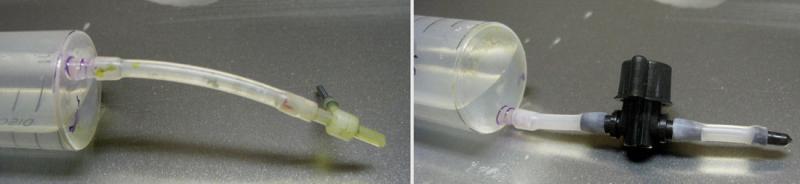

you can use pressure against the outlet of the damper and that works fine. but it is a complex maneuver. attached are some pics of syringes that i made for filling dampers. my favorite one is the on the right. it has the end of a head adapter chopped off and then placed inside of the rubber pump tubing. i highly recommend everyone making one of these.
