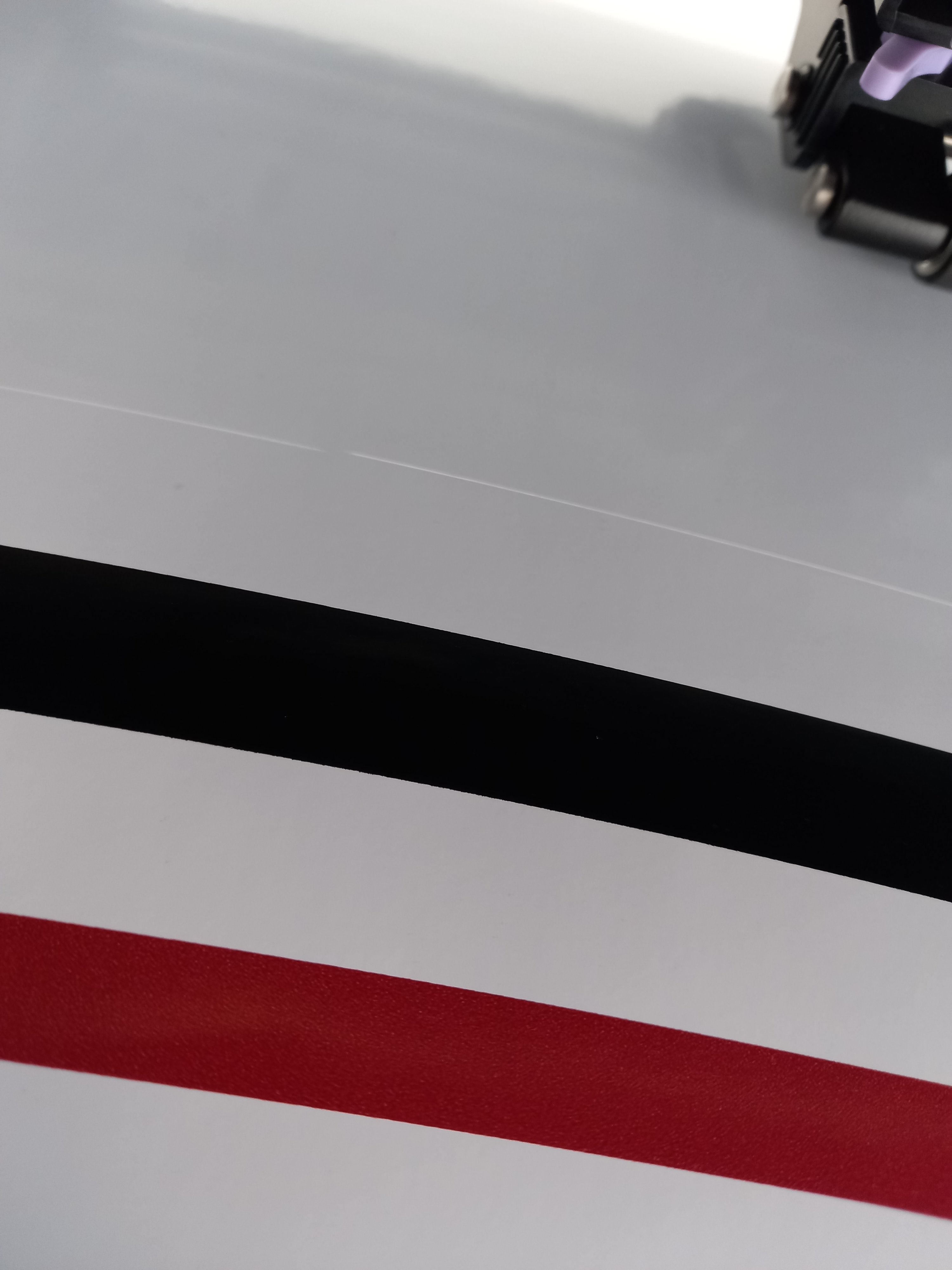

Hey guys quick question I find often on larger cut decals I'm having an issue where the cut doesn't line up. I am using register marks and have previously calibrated the print and cut in rasterlink and changed the offsets (on the printer) so it matches the print cut test with registration marks. Do I have to do this rest everytime I print and cut? Info this is a 1200mm by 800mm decal 20210624_100644.jpg

Am I reading the picture correctly and the cut is about 1.5" too far up? If that's the case, are you printing and cutting immediately after or are you laminating or something like that in between?
BRated
This was print and cut straight after, no lamination, and i had registration marks. Sometimes i have this issue sometimes i dont i think ive found a decent pressure on the rollers that it isnt much of a problem.
