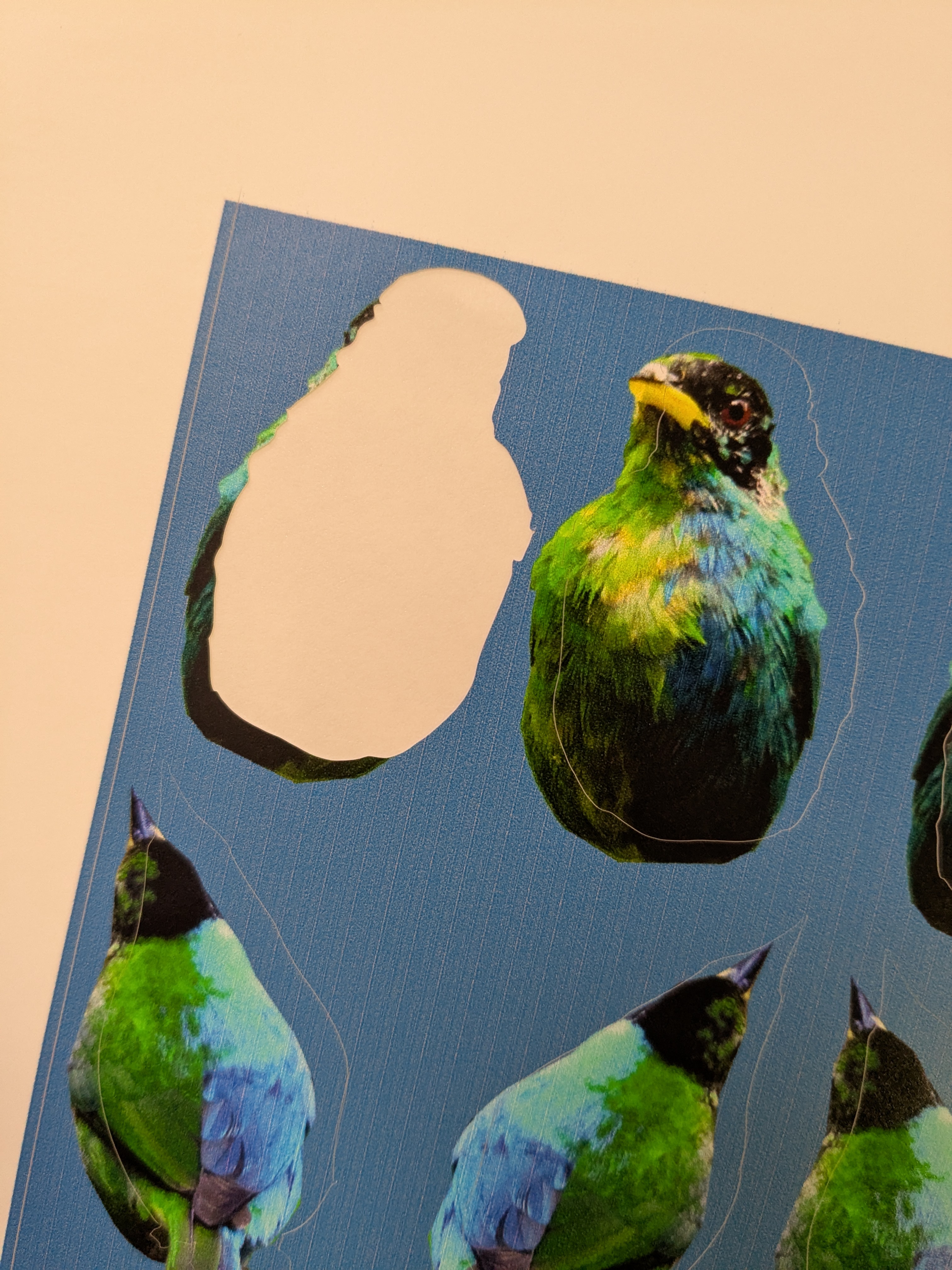

I'm trying to print/cut a 6 mil Rad Graphix vinyl (not laminated) and the alignment is WAY off.
I've tried: printing one repeat at a time, one row of repeats at a time, adjusting the print/cut alignment settings in the printer menu. I tried printing on my regular 3M vinyl, no laminate... got same bad alignment when I told it to print & cut in the same job. But got GOOD alignment with regular vinyl when I printed first with registration marks, then lined up the marks and told it to cut. But that trick did not work with the Rad Graphix vinyl.

I've not used it myself, but it sounds like this vinyl is probably reflecting too much infrared. Try putting a patch of normal vinyl where the registration marks would print and see if there's a difference.
