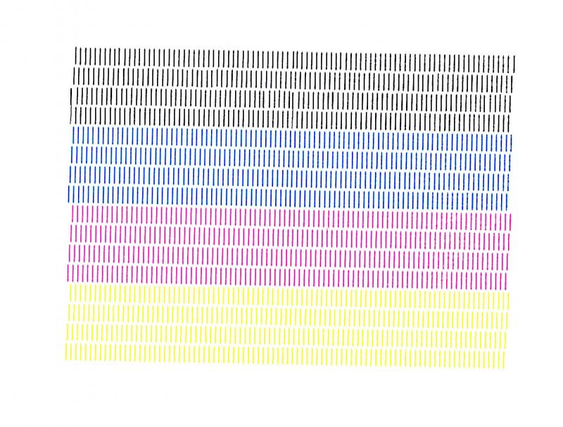

What do you make of this? The Black is a bit off. The reseller will enforce the idea of a head change for sure, but is it necessary?

Obviously you have a few black nozzles slightly off. Don't think it's really a calibration thing or they all would be off the same from the other colors and it's onlt a few of them. I'd say run it until it gets much worse, especially in the black, I can't believe you can even tell in a print. Now if it were magenta or cyan you might start seein a slight problem.
