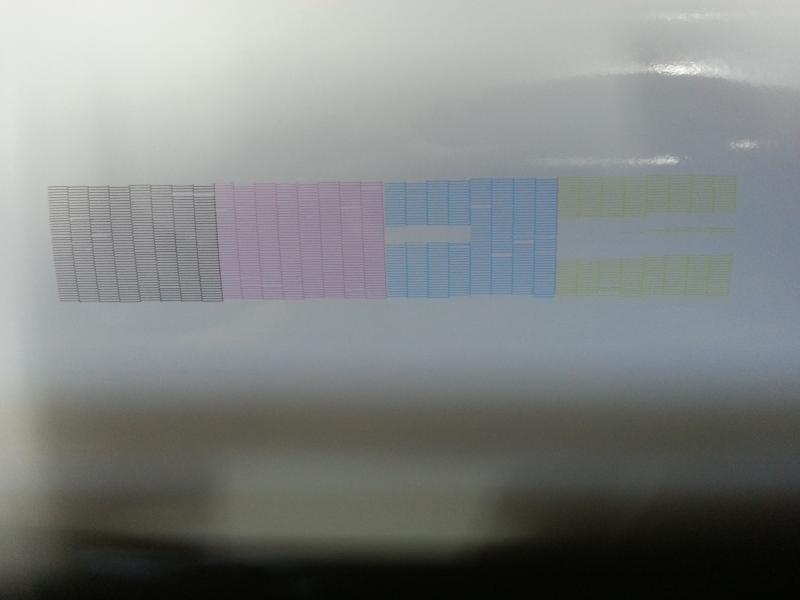

Hi Guys, i just purchashed my first solvent printer, its a second hand mimaki jv3 160 sp. It was printing ok in the sign shop but the black inks were very low and the magenta head was bad. I bought it with the intention of putting a new magenta head in. After a previous post i was advised to go throught the cleaning stages of the printer and found the capping station wasnt sucking on the magenta head, after further investigation i found the rubber tube underneath was blocked with dried ink. I removed the full capping station and cleaned it all with solvent cleaning solution. After refitting i was able to perform a full clean on the black and magenta heads and they come good. The yellow however still isnt good. Ive left the printer heads soaking in a nozzle wash all nigh and will perform another clean tomorrow to see if this improves the yeallow and blue head. I have an ultrasonic cleaner and was gonna try that to see if it will unblock the heads.

Have you visually inspected the bottom of the yellow head? That sort of pattern is sometimes a bad head strike.

Hi george
the test draw showing some nozzles giving cross firing for this clean the head with cleaning solution and check head height it should be 1.5mm and
for yellow blockage check capping assy then fill the dampers and apply ink fillup may be some air in head
