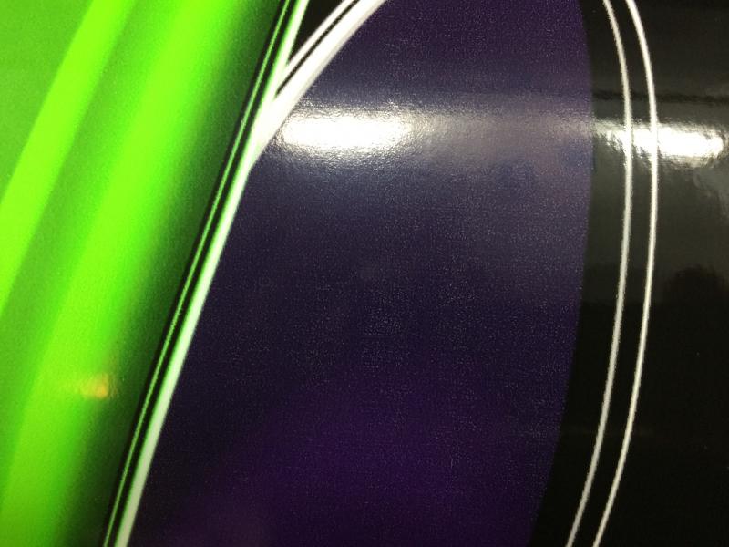

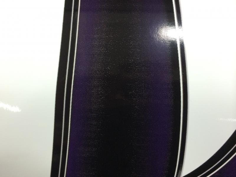

Hey guys I was hoping someone could educate me on why I am seeing this issue in my prints. I am using Avery MPI 1005 and printing it with a GS6000. It is intermittent as well. Any thoughts?
It look like the material can not take too much ink. Try lower the ink limit or use different material.
Could be a bad roll...Have you tried contacting Avery?
TimToad
Is it only doing it on the heavily saturated colors or is the distressed pattern running through everything regardless of color?
Rage Wraps
I was thinking maybe a bad roll also but that will be the second one out if the last four. At first I thought the heavily saturated colors as well but there was an entire field of straight black and it didn't do it also. Plus I ran it twice and it did it in different spots as well.
