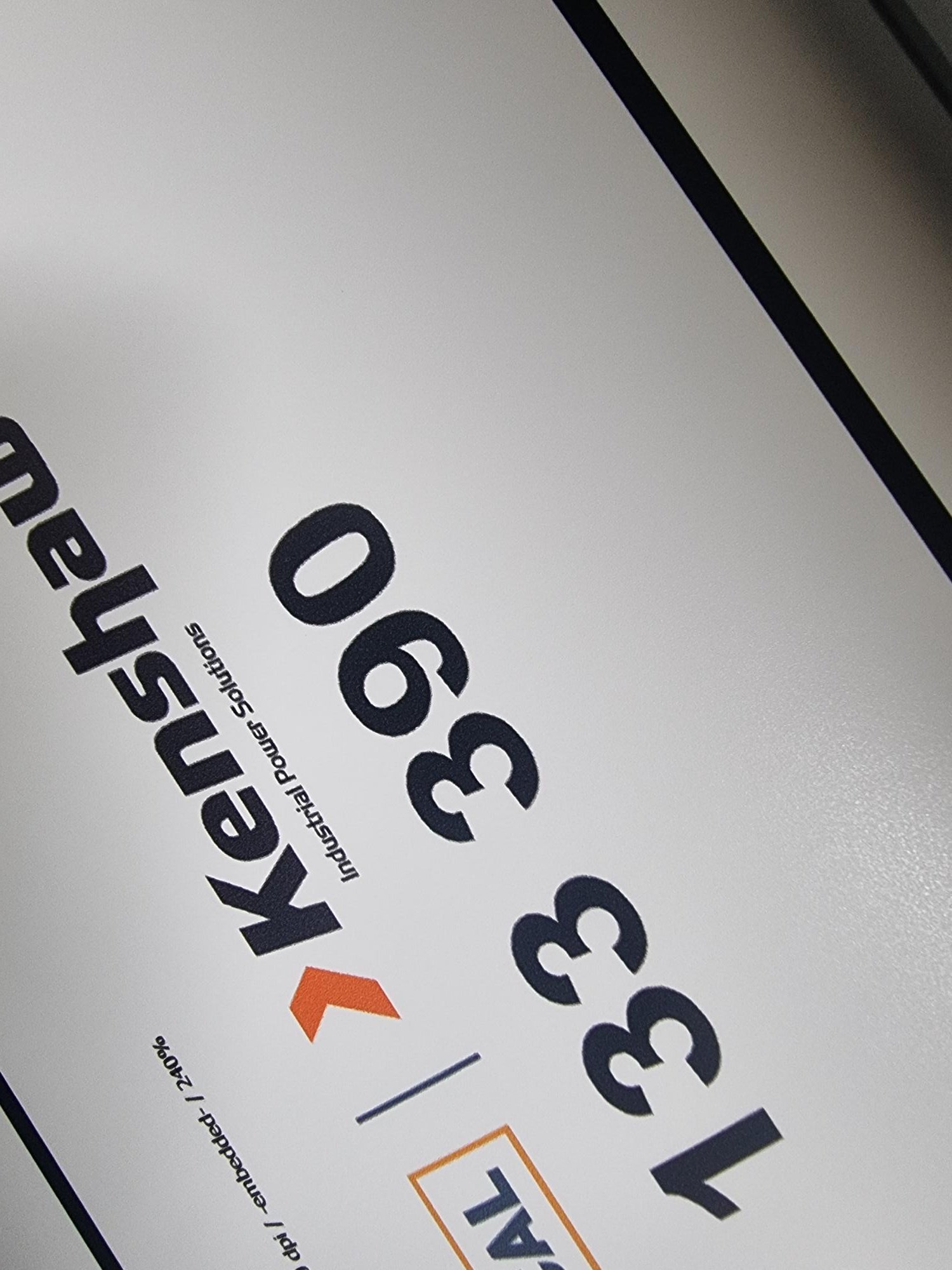

Just printing some stickers off and noticed furry edges on the print. I am pretty sure i had a similar issue on my old roland may have been encoder strip or bio direction maybe ? I have done the auto media set up as per the tech direction but still the same. If anyone can offer some direction thanks in advance

What resolution are you printing at? Bi-direction or Uni?
You can always try to a manual head alignment to see how those look.

Make sure the media settings are correct. See if there are any deflected nozzles on the nozzle test. Run the head alignments as previously suggested. You can also try uni or bi as they also suggested and try turning off one head to see if that makes a diff
