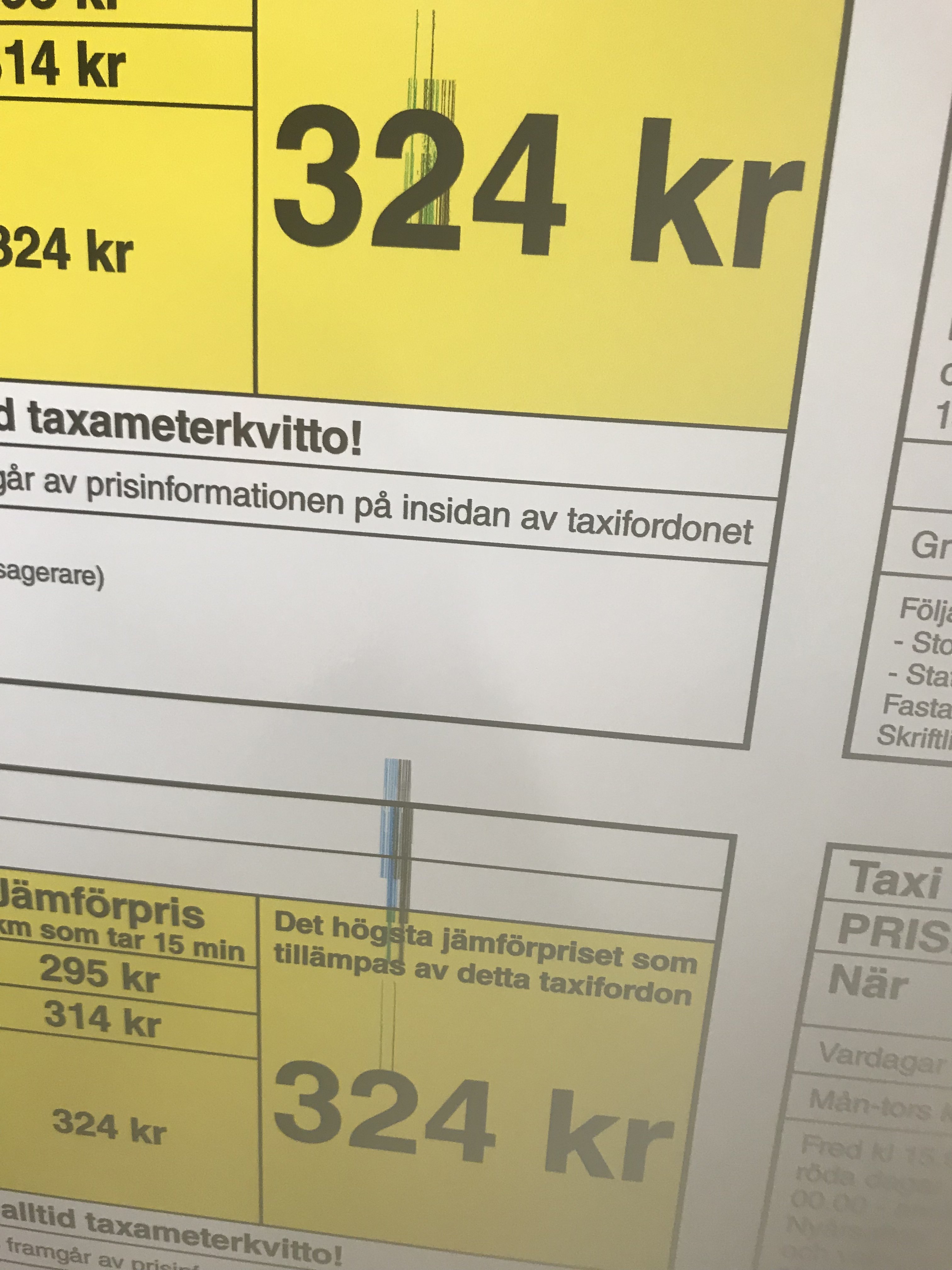

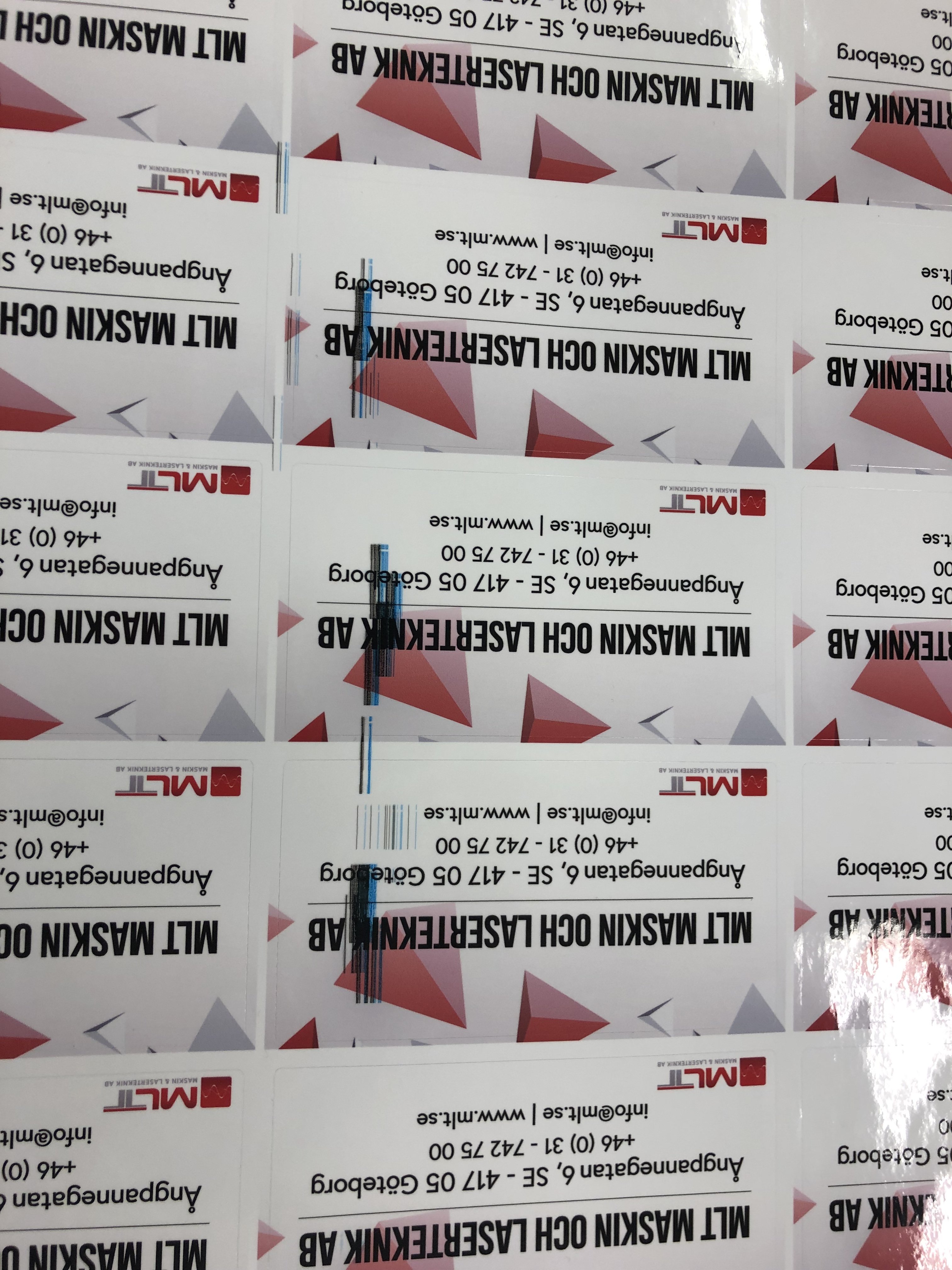

Has anyone seen these pattern? Have change a few things on the printer but problem stays....

That's your cyan/black head. Doesn't look like a simple head rub... You have the whole printhead touching there.
Are you using really cheap non latex material? It looks like the material is bunching up and causing it to touch the head. It's a little weird how it's like a perfect imprint... And just the one head. I'd take your cyan:black out and see if there's any defects.

I have rotated 4 different new printheads c/b. Not helping It also occurs on all materials.

Could be an encoder strip problem, try cleaning it with a lint free cloth (dry, no cleaning fluid) and see if that helps. Might also be a problem with the file, though it looks like you are getting it on 2 separate print files.
If you have proven that you don't need a new head then try to turn up the vacuum on your printer. Also make sure that you are using the correct profile.

It’s one head firing in one position. If you replaced the K-C heads then it’s an electronic problem.
It is usually the cable in the carriage track folded in one area. Need to have service replacement.

I don't work on HP or latex machines but that pattern looks exactly like when the machines I work on have electrical issues in the head signal circuit. Usually a bad cable but can be a bad head or other electrical board.

At first I thought head strike, but the way the lines all seem to start and stop exactly in line with each other makes me think that it's something else.
