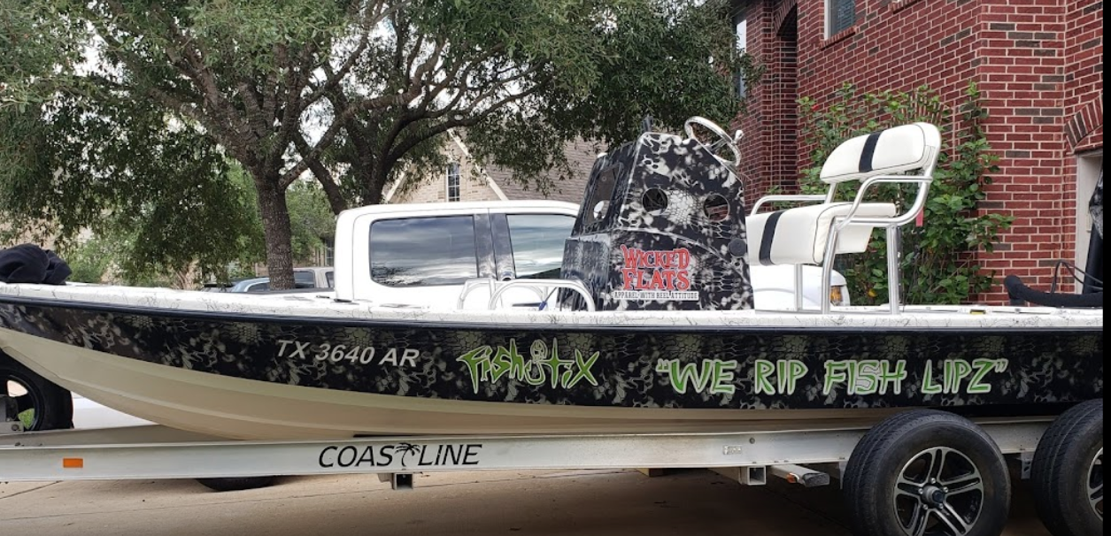

We did print a wrap on the 3m ij80mc and it gave it a metallic finish. It was pretty cool. This particular pattern is what locked up my rip station because the file was so big (layers on top of layers). Then we put the decals on top of it. The lettering on the bottom is printed reflective.
Looks great! Yes, I am pushing the client toward print media. We have done a few boats for this guy (they build them) and they have always chosen a metallic wrap vinyl. But now they want to get funky!
