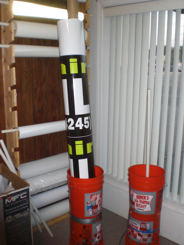

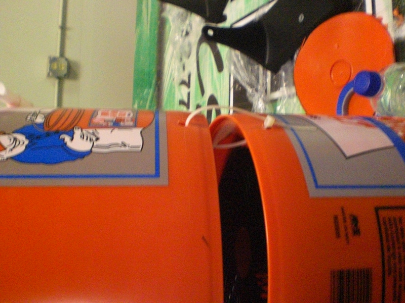

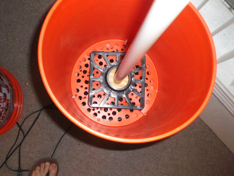

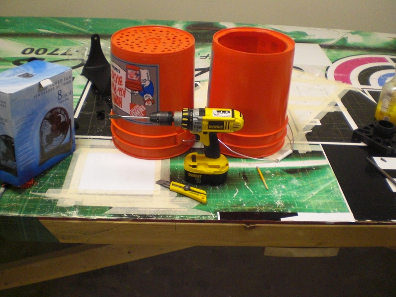

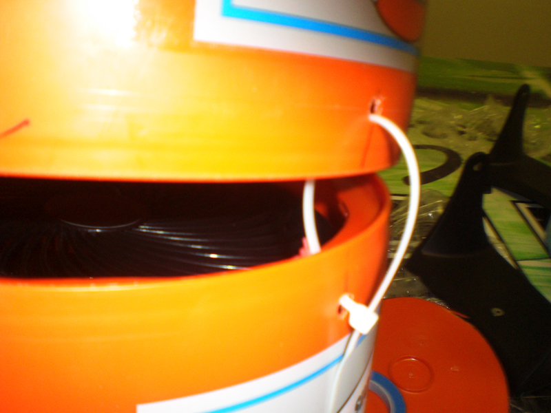

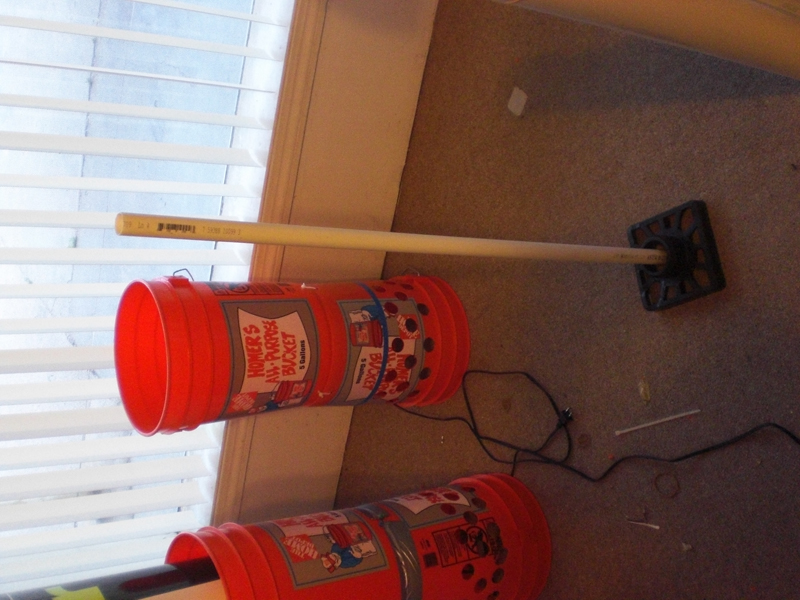

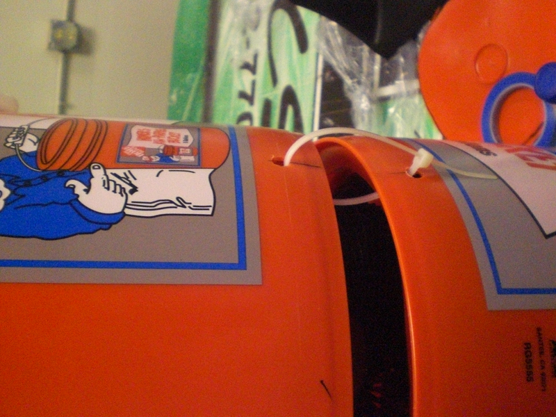

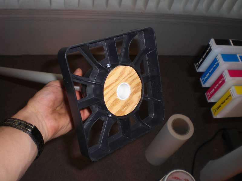

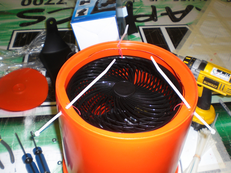

All my clients want everything the next day! i was worried my prints where not drying enough before laminating so after researching on this forum i decided to make a drying bucket out of 5gal buckets. Credit goes to whoever made the first version! Long Live Free Knowledge!
Here is the I.G. Version!
It cost
$3.00x2 buckets
$15 Fan
Zip Ties / Duck Tape / Drill / Bits / Super sharp utility knife (already had)
Total $19.00
It works great and holds 60" media and smaller with no problem!
-the fan is facing to blow up though the print
-What you cant see in the picture is the media holder is wire tired to the bucket
