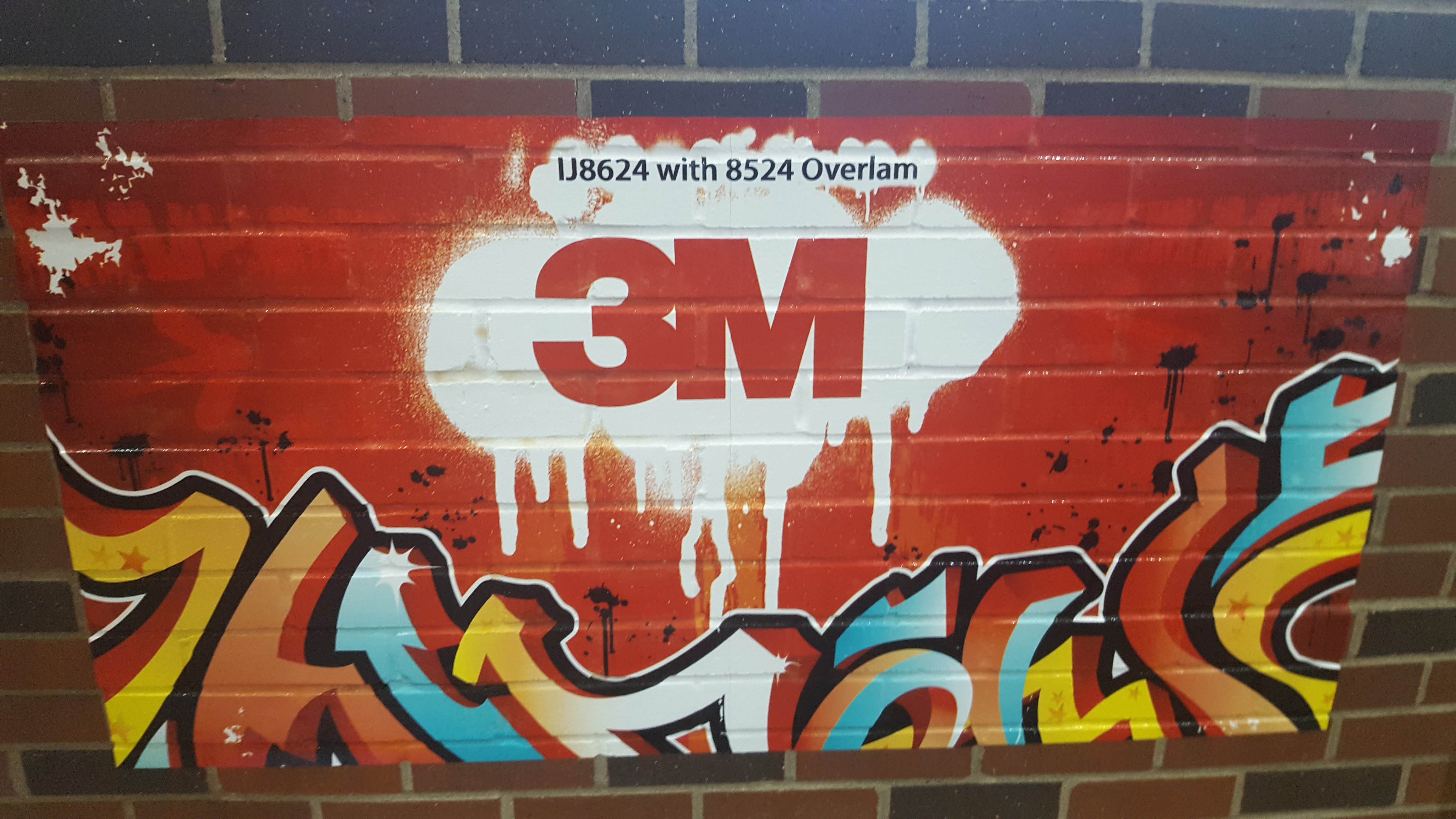

Here's a link tire of 8624... Can't see the grout lines too well, but you can see the does go in pretty good.
This was a pcture from an install course... So ignore all the burn marks it was my first time applying. Took 3-4 tries to get it down... and I'm sure I'd still burn some areas of I were to do one today.
I experimented with, and without the $250+ tool they provided... It stuck way better and went on much nicer with the tool. So if your having issues with it sticking to grout.. I'd check your tool if your using one for flat spots/cracks. And make sure it's getting enough heat

For Brick vinyl it's mostly about how you applicate it. Are you using the proper tool and a heat gun? It needs to be pressed in really tight, and heat gun set at 750-1000 degrees.
